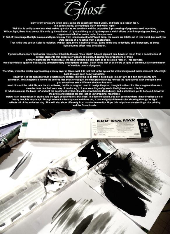

Hi everyone, and I'm new to this forum and need some help.
I'm sure you have all heard it before, about black ink not being true to it's name.
This is causing me some grief as I do fine art with a lot of detail and subtleties, and people expect to receive what they see on screen.
The issue is with a green tinge when the opacity of the print drops.
As I was an air brusher for more than a decade, I recently did a little experiment, so please see the attached as it describes my findings quite well. And in fact, had to post it in my site as a waiver, for too many people have been complaining about it.
So my question is, can I get ink somewhere that will be more true black than the current mixture/processing in the Ecosol Max brand, which is in fact made by Epson, and that will be compatible with my Roland.
Thanks for reading.

Did you look at the attached image? Look again.
I have pulled hair out over it. Tried everything under the sun, thus resorted to crude testing for this discovery.
It is clear to see that the black has green in it as it fades out.
This is directly from the ink tank, not the profile, didn't go through the printer, direct from tank to media. It has everything to do with 'chemistry' and not the profile, printer or anything else.

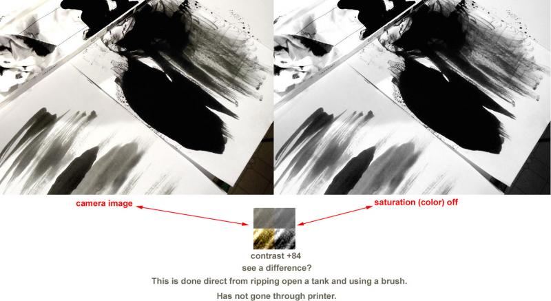

The point I am trying to stress here is that I am not printing the sample ink in the test displayed on this page, it was done outside of the machine. No printing, no profile, no ics, no other colors involved, just the black from the tank. The test is directly from the bag inside the tank, onto a paint brush, and onto media, and it shows green tint.

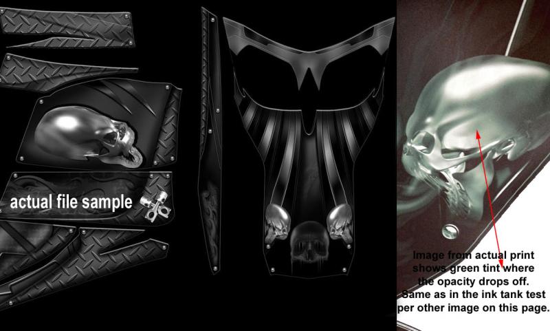

Totally, and thank you for stating that crutial point. And that's my problem as I'm rendering art, through the Roland, using the same techniques as when I was air brushing with paints and expecting the same results. However get green tints instead of grey as it fades out. Same as what happens when done outside of printer use. So that indicates it is the contents of the black itself, not the printing as the results are identical.
The Black is not pure black, and is what I'm trying to source for my Roland print work. If I were painting, say with Liquitex, AutoAir, PPG, etc... the black would be jet black, regardless of saturation or opacity.
I have attached another couple sample images here. On the right of one, I have stripped the color out of it so that one could see the color in the image to the left of it, which is not grey as the other 'stripped' image is.
The other image is a snip from a working black and white file, and to it's right, you can see the greenish tinge as the opacity value drops off and the white from behind reflects light back throug it.
So in respect of getting more accurate printing, I am seeking jet black ink.
Does it exist from any one?

Yes, the image was enhanced only to show what it looks like when I strip the color out of the image taken with camera. The color is visible to the naked eye.
I don't know why I'm not able to get my point across here, though if you take an old unused black tank, open it, do a swatch test as I have done, you will also see that where it bleeds off, fall off, fades, it will not show as black to grey. That is what I'm saying. The Ecosol Max black is not pure black and begins to 'show it's true colors' when dropping through various levels of saturation. It has green in it's makeup.

Hi Wayne, sorry I didn't notice your post earlier.
You might have a point there, however I am more than pleased with the output of my Roland at this time, just the black being an issue for doing graphics for guys with black panels. They notice right away, and scream at me for it. That has been costing me, as I'm good about it and offer substitution/replacement. Here being the latest:
I'm NOT satisfied at all with the color....the gun metal on the
computer screen looks totally different...they actually almost have a
dark forest green tint....my ski is white black and grey and these do not flow with the bike.....
