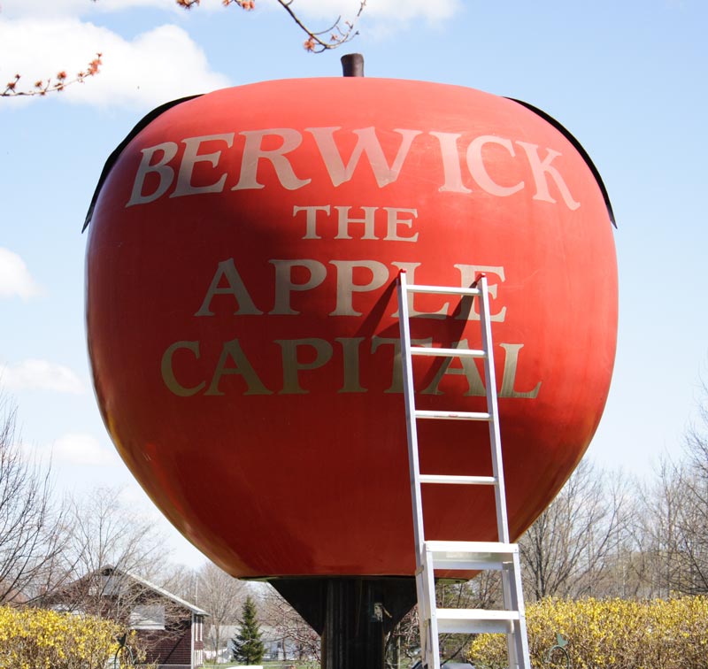

This is the Big Apple. It's about 10 feet in diameter and it's about 16 feet tall. It needs new lettering. The lettering is vinyl...or it was vinyl. Now it's mostly glue.
No one remembers who made the apple or obviously what it was painted with. I can tell it was sprayed but that's about it. Under the paint is a layer of grey primer(I assume it's primer) and under that it looks like red paint or gel coat....can't tell for sure. There are no cracks or alligatored areas.
The paint is well adheared to the thing but badly chalked on the south face....which is the face that the lettering is on. I think I need to paint the apple to get rid of the substantial ghost that will be left behind. I thought I would scuff sand the whole apple with 320 in my random orbit sander and re-paint with Rustolium and a foam roller. (It left a decent finish on a test I did with scrap Alupanel.)
Am I on the right track ....or heading for disaster? I haven't given a quote yet....just measured the thing and picked at the edge of one of the letters.

I'd say you're on the right track for refinishing. Maybe add some generic hardener to the enamel when you paint.

I am thinking maybe a pressure washer would be a good idea too, after the sanding step to get rid of any dust/gunk etc.

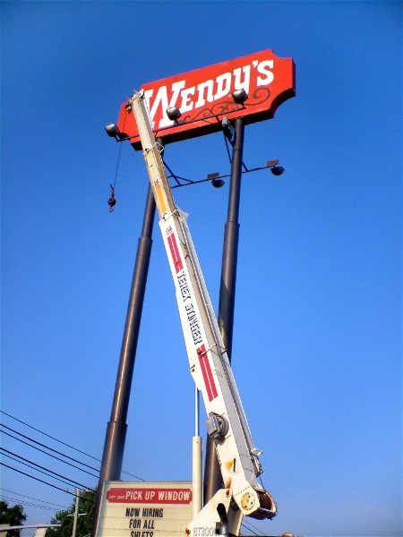

I have some ancient Rustoluem signs out there so I can attest to its longevity. You might also want to give Ronan Speednamel a try. I was really pleased with it on my big Wendy's sign from last summer.
I'd make the lettering a little bit smaller, fix the kerning on the "W/I" and maybe paint it in white rather than gold for more contrast.

IS IT METAL OR FIBERGLASS???? iam sure you dont want to attack that with an ORBITAL SANDER, you will be there a month. i would find a guy with a portable sandblaster, to get the glue off and some of the bad parts of the paint, and reprime and paint it with a sherwin williams INDUSTRIAL PAINT. expensive but the right paint for the job since its gona be red, and that it is a high fade color. wait a week, and THEN i would draw each individual letter with a card board template that is the width and height of the letters.......because of the curvature of the apple. gold paint is not one of the best for longevity.i would look into some AUTOMOTIVE GOLD PAINT if you want it to last and you would have to brush it quick. and i agree a black line would be the best to make it look complete.

It's fibreglass OP. The orbital is a Dewalt random orbit sander. I once stripped a car to bare metal with it. This just needs a scuff sand to clean off the chalked side and and give the new paint something to grip. The paint is actually in pretty good shape. It's the ghosting that'll look awefull if I don't re-paint it. The glue may tough to remove. There's just a hint of the vinyl left and it's all alligatored and dusty, but just gummy enough to make sanding look like it will be a hard job.

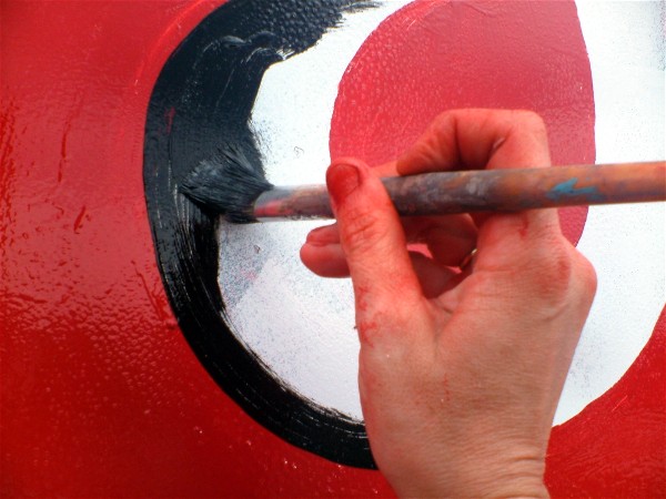

I used Ronan's Speednamel on my big sign.
Not sure if it's available up there but I liked working with it.
I had red hands for about a week afterward so I know it's durable.
