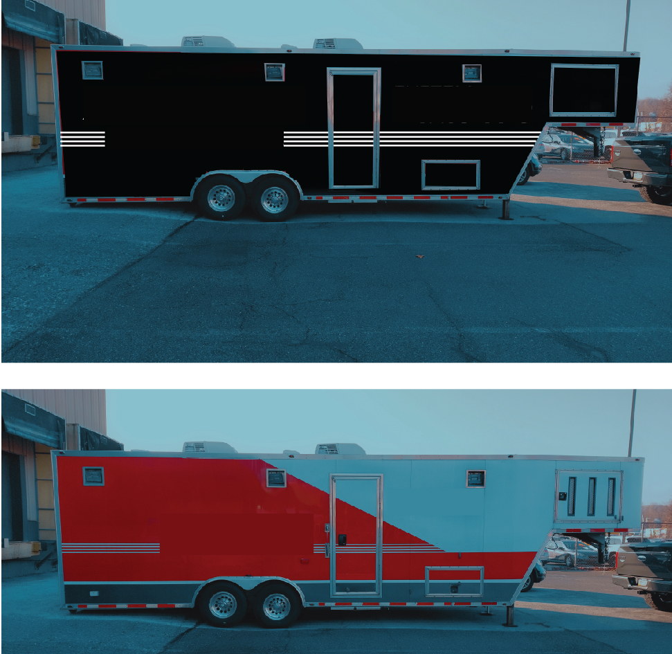

They have access to a paint & body shop..... and one of the best in the country, but for some reason cannot use it right now. I think there's some extenuating circumstances, but that's none of my business. I found this out by telling them, if they want a trailer that is painted 1/2 red on a white foundation and now want it matte black, they should paint it, not color change it with wrap vinyl. He nixed that by saying..... we can't use our paint booths.
. . . . . . . . Oh freddie........ I've been here for a little while, no need to be welcoming me anywhere :toasting:
Maybe this will help. They want the red/white to become ALL matte black. Do you see all the incidentals with caulking needs ??
