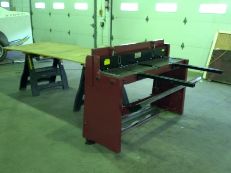

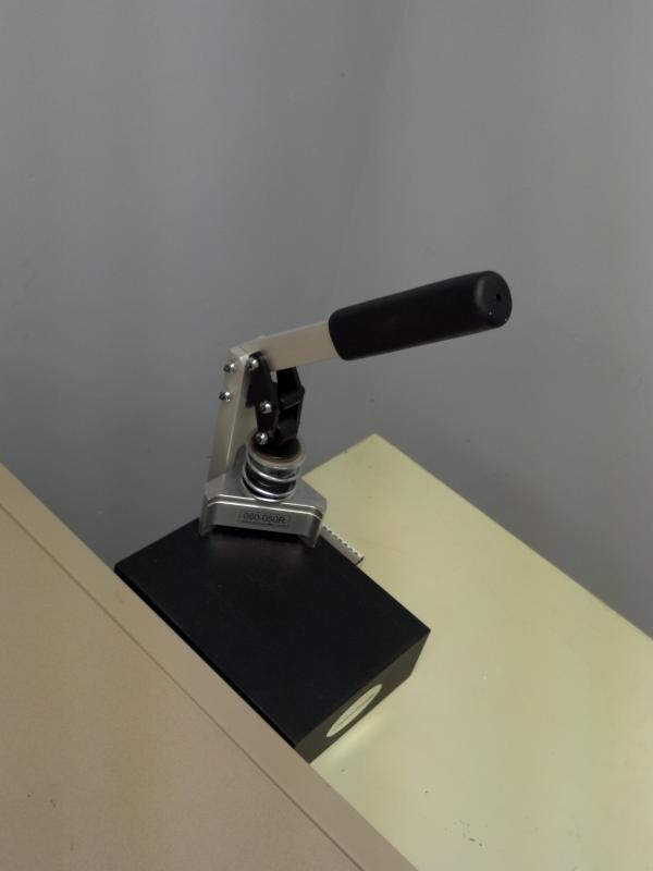

Just finished setting up the new 52" sheet metal shear and our accucutter corner rounding tool!
Both of them cut like butter and will be a great addition to the shop!
Anyone in the area need blanks cut and rounded let me know!

Tell more about that shear... that would be very nice to have around. How much did it cost?
It is a 52" sheet metal shear from Northern Tools. We paid a little over a grand on it and then about $200 more in modifications we made to it. Didn't like the way the rear of it was set up so we made some of our own custom stuff. Will post some pics of that later.

So, if you need 6pcs 2' x 8' cut down from 4' x 8's...... how does this work ??
Mark the 4x8 sheet every 2 feet (mark two extra inches gives you line point to slice) and put it on there, line up the marks, check square, step on the foot pedal. Slide it forward to next mark, line up, check square, step on foot pedal. Repeat...

I'm confused on that. It only has a 52" width. It would seem impossible to use it to cut a 4x8 sheet lengthwise.
SightLine
Even if it had a 96" width I doubt you would be able to jump hard enough to cut anything of much thickness at that length. I cannot recall ever having seen a jump shear wider than about 60". Any wider are generally powered. A friend has a 50" and cutting full 48" .080 aluminum is barely doable - you have to jump about as hard as you can (and the fatter you are the better lol) to chop aluminum that thick.
