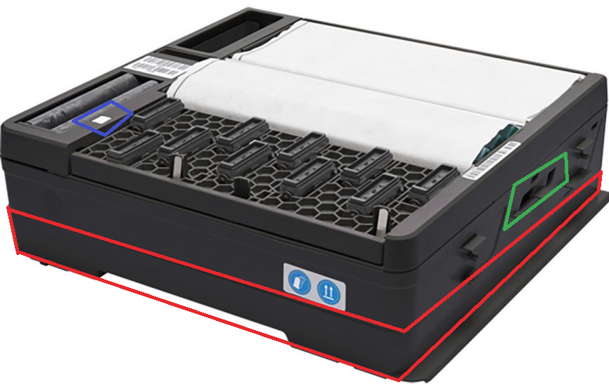

A little tip for you guys who are already using the printer. Especially if you use a lot of white ink, you can possibly even double the life of your maintenance cartridge this way.
Because it stores the waste ink at the bottom, it doesn't always completely use the cleaning roll.
By removing the waste ink from the bottom (red) and resetting the flag (blue), you can use the full amount of the cleaning roll in case there is some left (green).
Just suck the waste ink out of the bottom and discard it. Put a piece of (preferably paper sticker) vinyl on top of the old if it's not white any longer. And check the remaining amount of cleaning roll from the window.
Now the printer will still know approx when the cleaning roll is ending because there is a flag there. Usually the usage is just limited by the waste ink (especially using white).
I do recommend doing this before hitting 0% as you risk ruining your new part of cleaning roll if the waste ink touches it.

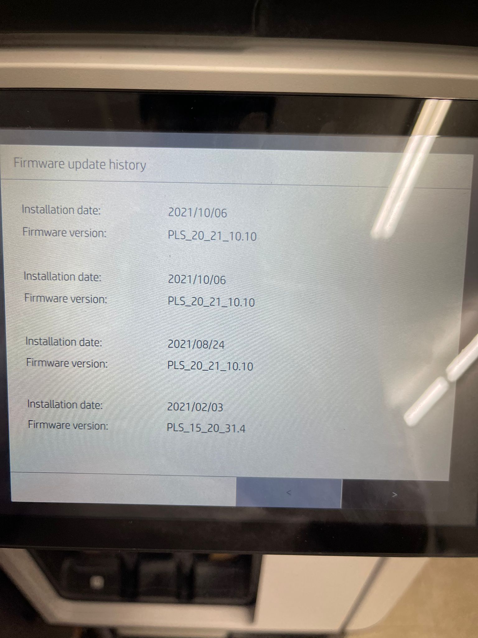

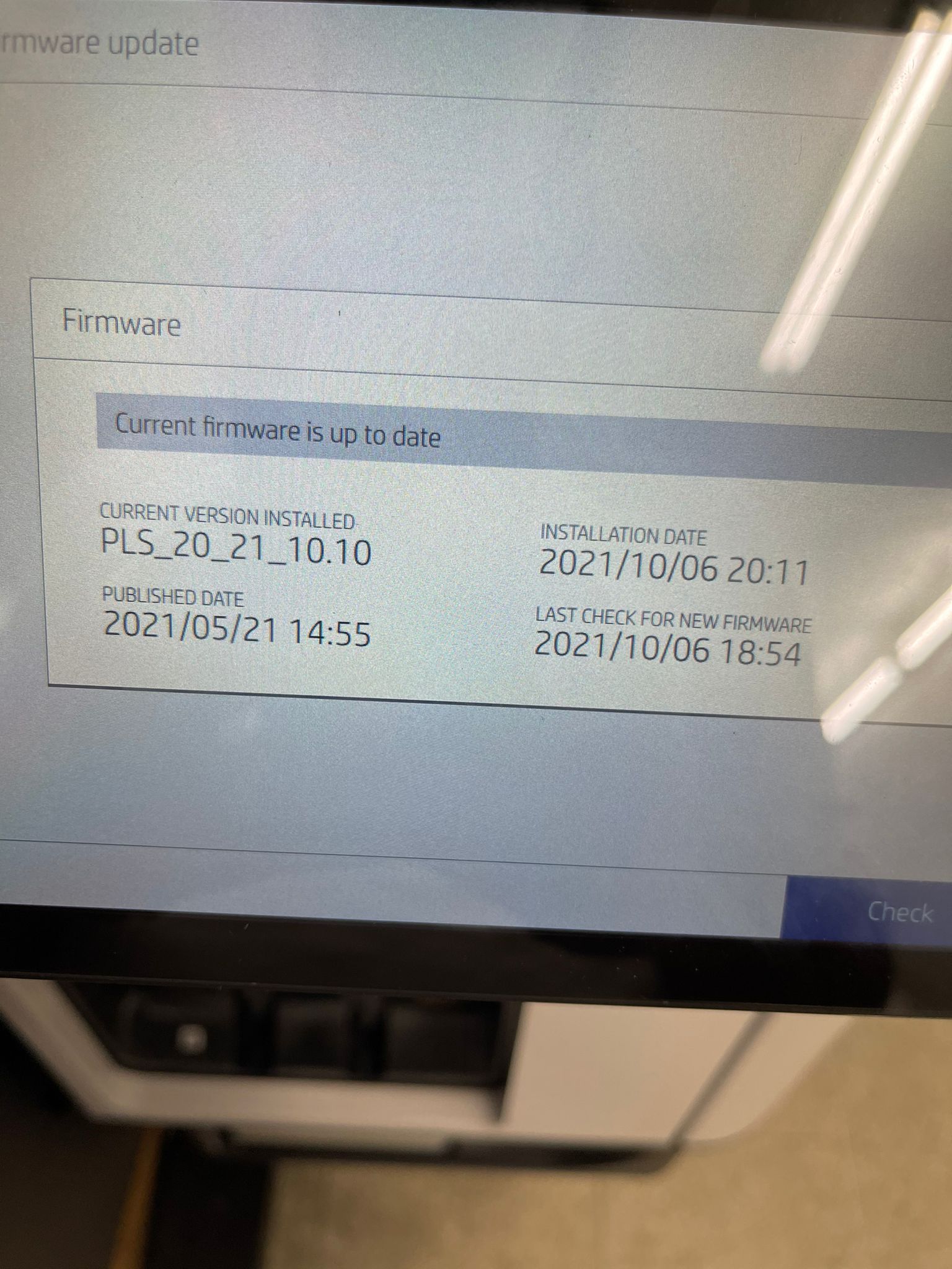

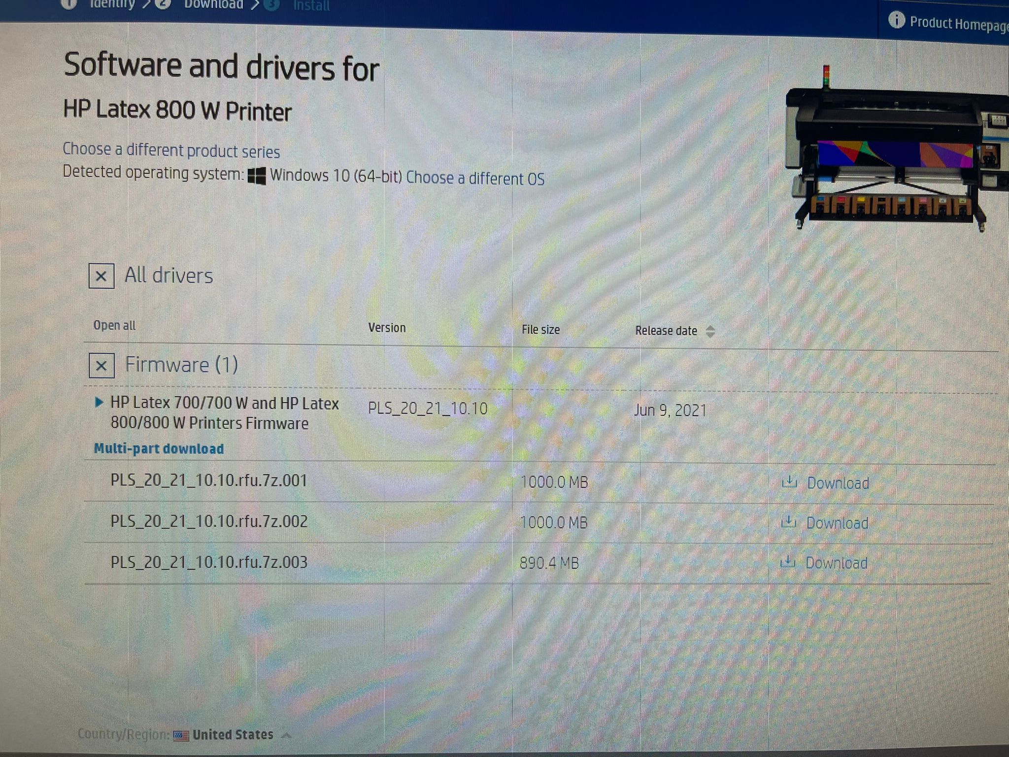

I did went to HP support website to download the new firmware can you care to share the link from where I can get it. The one they have on there website is PLS_20
balstestrat
Problem Solver
It's not there yet, probably takes few days. Just let the printer download it.
Front panel main menu -> About printer -> Left side Firmware tab -> check.

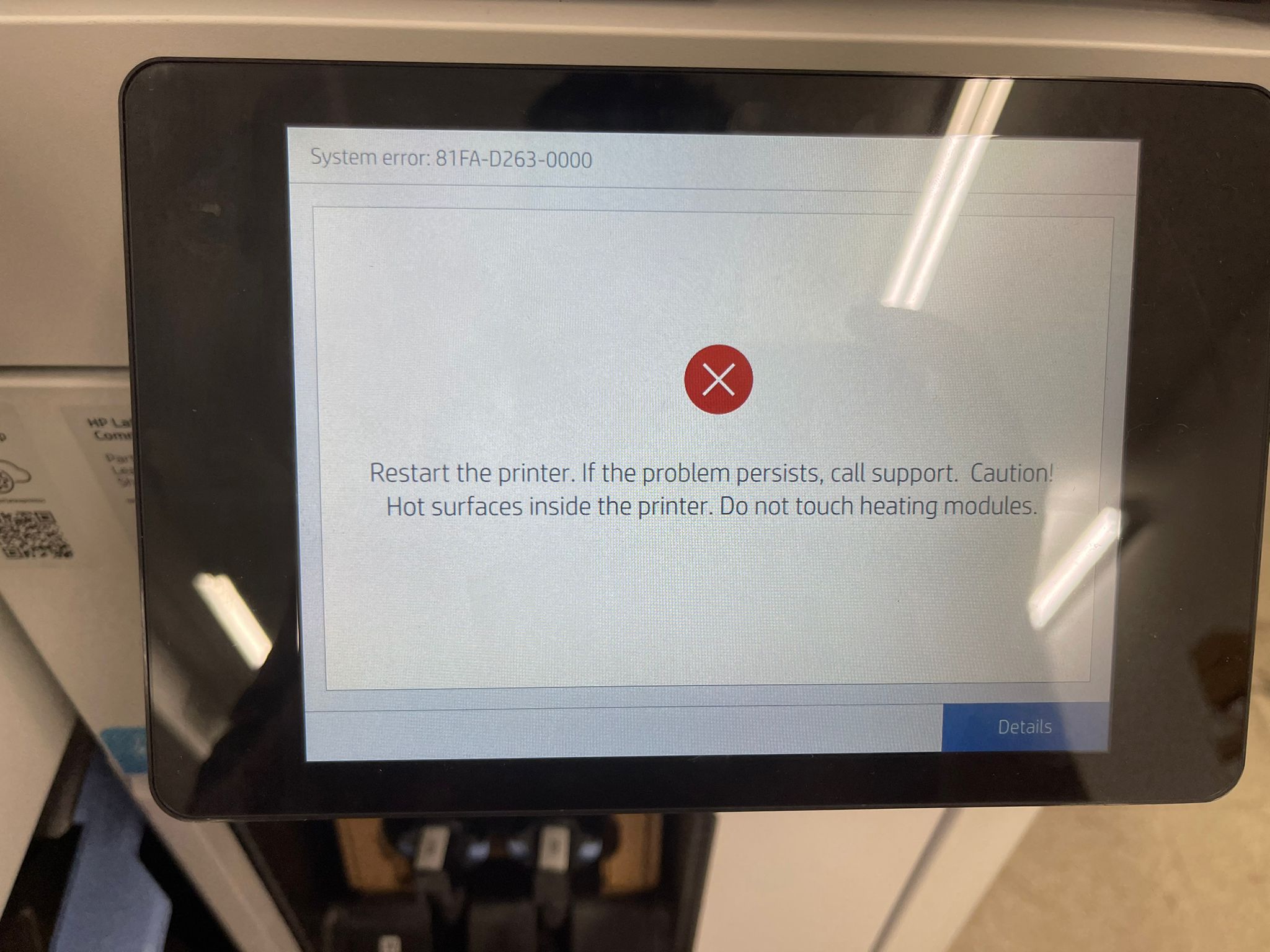

That's not an issue but it's not letting me print anything at the moment. and the bad thing with me is I don't have any backup printer to run the jobs. :s

I tried to update with the one they have online and did all the cache clear procedures as well as having their tech support on call. But as I send the print this error pops up rightaway. only when I send the print. If I restart the machine and don't send any printing no issue. even did the head alignment no issue. It's confusing don't know what to do.

Okay mate, what ever. I just checked and the PLS_26_******** is supposed to fix that error.
So you can let the printer update for 30mins and get rid of the error or wait until.........

Thanks for all the help bro. Just waiting on this update to get available in the machine so I let it update I don't mind 30 mins or 1 hour :D
