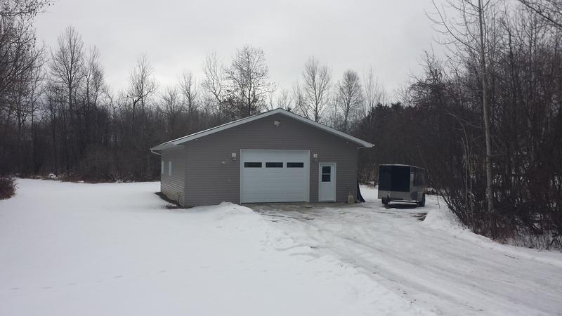

Sure you can. Cost to build landed about $65,000
Did a lot of the work myself too, but some of the things that added up quickly were:
-20 loads of gravel to raise the grade up to what I wanted
-In floor heating system including 2" styrofoam under the slab
-2X6 construction with R-40 blown in the ceiling
-Trenches from the house (120' away) for gas line and water line - I have a toilet drain and water line in case i want to frame a bathroom in the corner later on
-Garaga overhead door with R-17 insulation
-Camera and motion sensor security system
-And the floor was $3000- 2 for the stain and epoxy and 1 for the laminate.
And as requested here is a pic of the outside

Nice job on your building, I built my 3200 s/f home here in Texas back in 1993, I did it part time (evenings and weekends) so it took me 2-1/2 years, I did all the framing (even the cut on-site hip roof that was a big challenge for me), plumbing, electrical, drywall, trim work etc., but the large concrete slab I had to have done by the pros.
I have a question about the In floor heating system, is this the ONLY heating source for the building?
I would imagine it takes a while to heat the slab first before the heat can start to radiate upwards into the work space, so is this something that you leave on all the time in the winter?
Is the In floor heating system electric or heated water in pipes (give details please)?
And again, you did a great job, you can be proud of your accomplishment, anyone can write a check. :clapping:

YES. It's the only source & it works quite well
It actually only takes a couple hours to bump it up a few degrees, but I work here full-time, so there's no need to turn it down.
It's Natural Gas boiler with an electric pump to circulate the glycol
It has 6 seamless loops under the slab with 2" styrofoam under it and around the sides of the foundation.
I keep it at about 17 Celcius (about 65 F.) any warmer and you feel too hot- I guess due to the warmth radiating from your feet and everything you touch.
And the best part other than warm concrete floors is no dust from a furnace fan!
Thanks! & although I did a great deal myself, sadly, I still had to write a lot of checks
