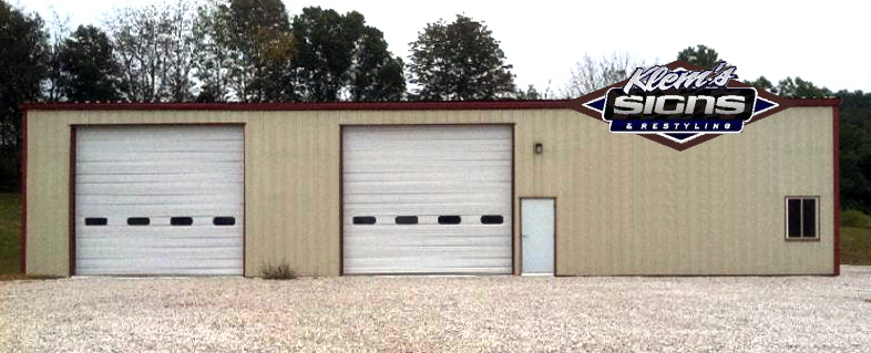

Finally getting around to working on a proper sign for my shop, been almost 4 years since I built this building and I think making my own sign is way overdue.
Size of the sign is rougly 8' x 21'.
My thought at the moment is to build it out of dibond and pvc with about a 1.5" aluminum tube frame behind so it stands off the wall nicely. I would cut the letters of Klem's, SIGNS, & RESTYLING from 1" pvc for some dimension. Also the diamond shape and the rectangular shape would be separate with some spacers between for some added depth.
I thought some sort of flourescent flood lighting from above might look good.
Then when I finish this I plan on putting a lighted cabinet or channel letter sign of some sort by the highway.
Any and all thoughts, criticism, ideas, good bad and ugly are greatly appreciated! I've only been doing this type of work for 10 years and I have a lot to learn still, so I look to the masters of the trade for any advice I can get.

Can't help but smile of the name.. Klem in norwegian means "hug". Makes me read "embrace graphics" which really isn't a too bad doble meaning ;)
I think the sign looks good. Very masculine, though and stylish :)
GypsyGraphics
looks great!
i like it higher too, it shows better and breaks the line of the flat roof.
in proportion to the first two words, i think "& restyling" could be a bit larger.

The idea of extending the sign above the roofline is not all that appealing to me.
It does, however, leave a lot of space on the wall for other stuff.
What I dont like about the sign going higher than the roofline is the exposure to wind and snow accumulation. ( Not sure if wind and snow are an issue in So. Indiana?)
I agree that Restyling could be slightly larger.
Perhaps consider LED lighting...lower power cost and less maintenance.

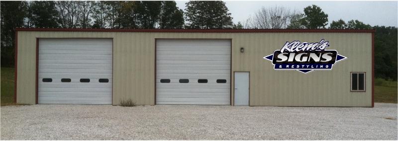

Klem is my last name. I'll try enlarging restyling some also. My concerns with extending it beyond the roofline would be wind & snow load, a ton of blank "canvas" below the sign, and the roof sticks out probably 4-6" past the wall so the bottom of the sign would have to be that far off the wall too. Maybe if I just raise it up closer to the trim?

Looks pretty nice that does.Would look real sharp with some LED going on somewhere in there.
MikesSigns
Congratulations on finding time to do your own sign. Took me a few years also. Would had been quicker to have someone else do it .I like it peeking up over the roof line also.You should consider maybe painting the front of building with a color that makes your work pop. Take advantage of the garage door space as well, lettering your services,web site, and phone number. ENJOY
phototec

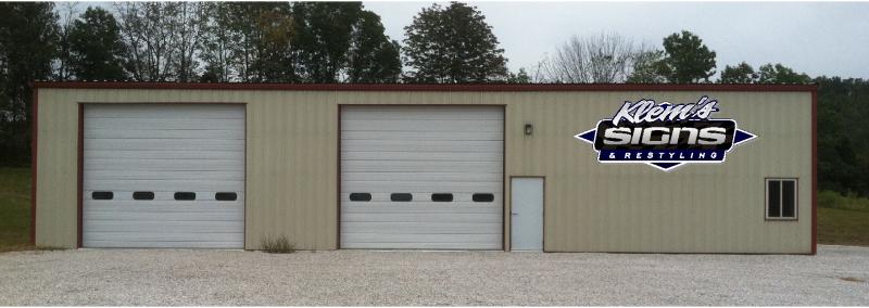

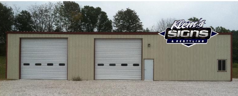

I like the idea of raising the sign, however with the tree line in the background it makes it hard to read.
If you added a background panel behind the graphics, it might help (examples)?

visual800
Why did you raise it? I liked it down in center of building like you first had it. When you raise something over roof you have to consider the colors of sign will now clash with backgrounds of scenery and possibly not show up, That building is out in open land it does not need to be at top on on top of building IMO.
Bring it back down and dont add anything else to it, we already know your a sign company no need in placing 15 bullet items on building and trashing it
Jillbeans
Keep it below the roof so it's "framed" by the negative space of the building.
Try A&S Truckin' Thick and Thin for the SIGNS, its G is more G-looking.

Guess I should have picked some different colors when I built it as I really don't feel like painting a 4yr old building. Landscaping was always the idea, maybe next spring we can make that happen. For now it will probably have to stay a rental storage box.
I think I will lower it back down to where I had it and try Jill's suggestion on the font of signs, I may be wrong but it just doesn't look right to me being above the roof line.

I liked where you had it first. I think the "Klem's" name could actully be a bit smaller. Should look really nice, good job!

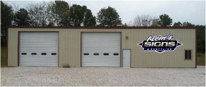

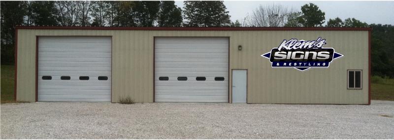

Here are the last 2 that I came up with, one is with Jill's font suggestion for signs. What I meant by LED's was putting them around the perimiter of the entire sign making the wall glow. I would probably do them in blue but I really don't know if it would look right or even show up if I have spotlights on it also.
Just a thought, maybe a dumb one at that.
