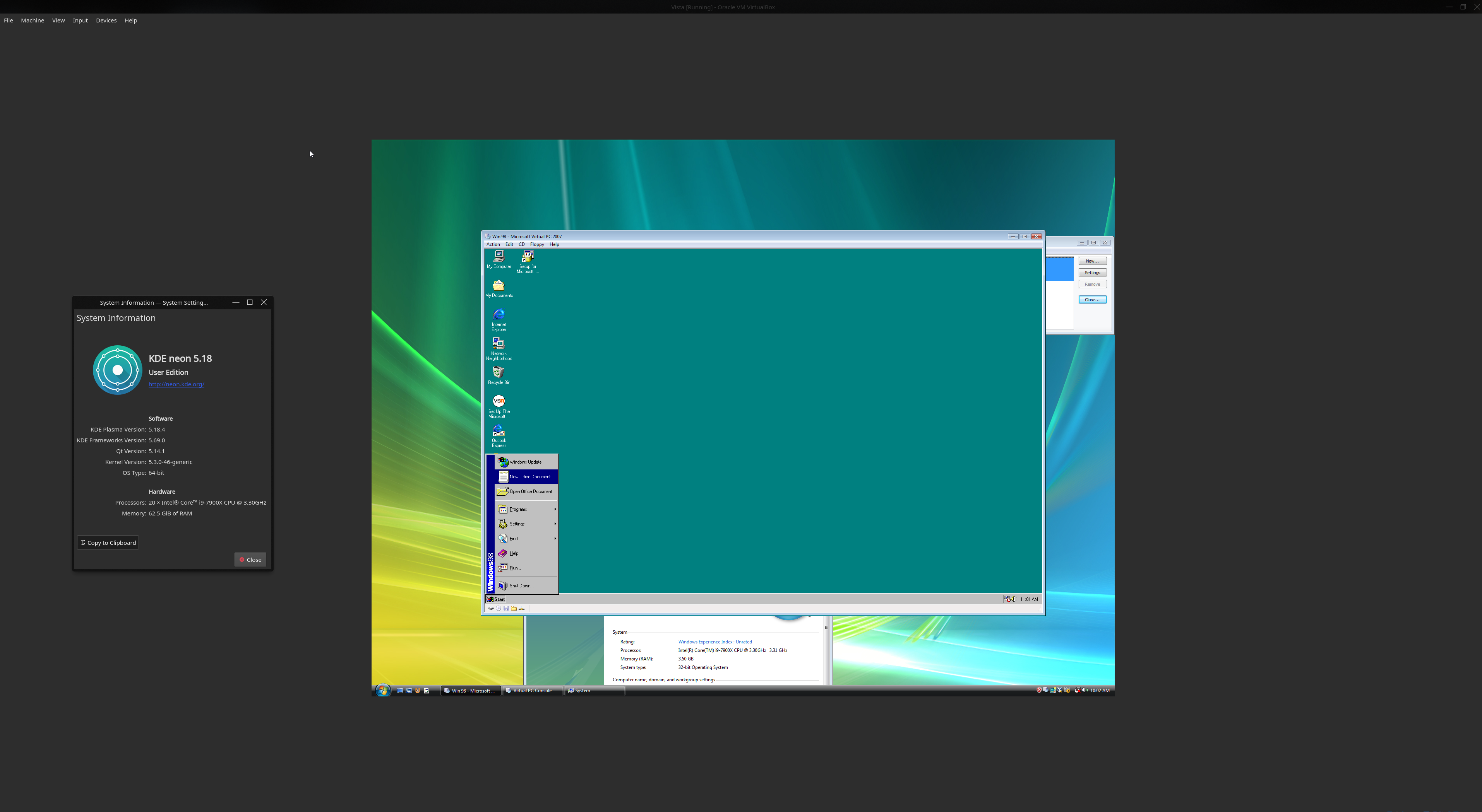

Setting up a 32bit guest on a 64 bit machine is not an issue at all. I run Vista 32bit on a KDE Neon 64 bit host. Within that same Vista VM, I have Win 98 in a VM (VM within a VM), communication is flawless and that's going through 64 bit to 32 bit to 16/32bit. The issue is the serial communication. Also depending on what VM software you are running as well. Some don't do well with others in the more nuanced features.

It works, bottom line. Hell, even MS had XPM for Win 7 pro users to run XP in and that is a VM environment.
