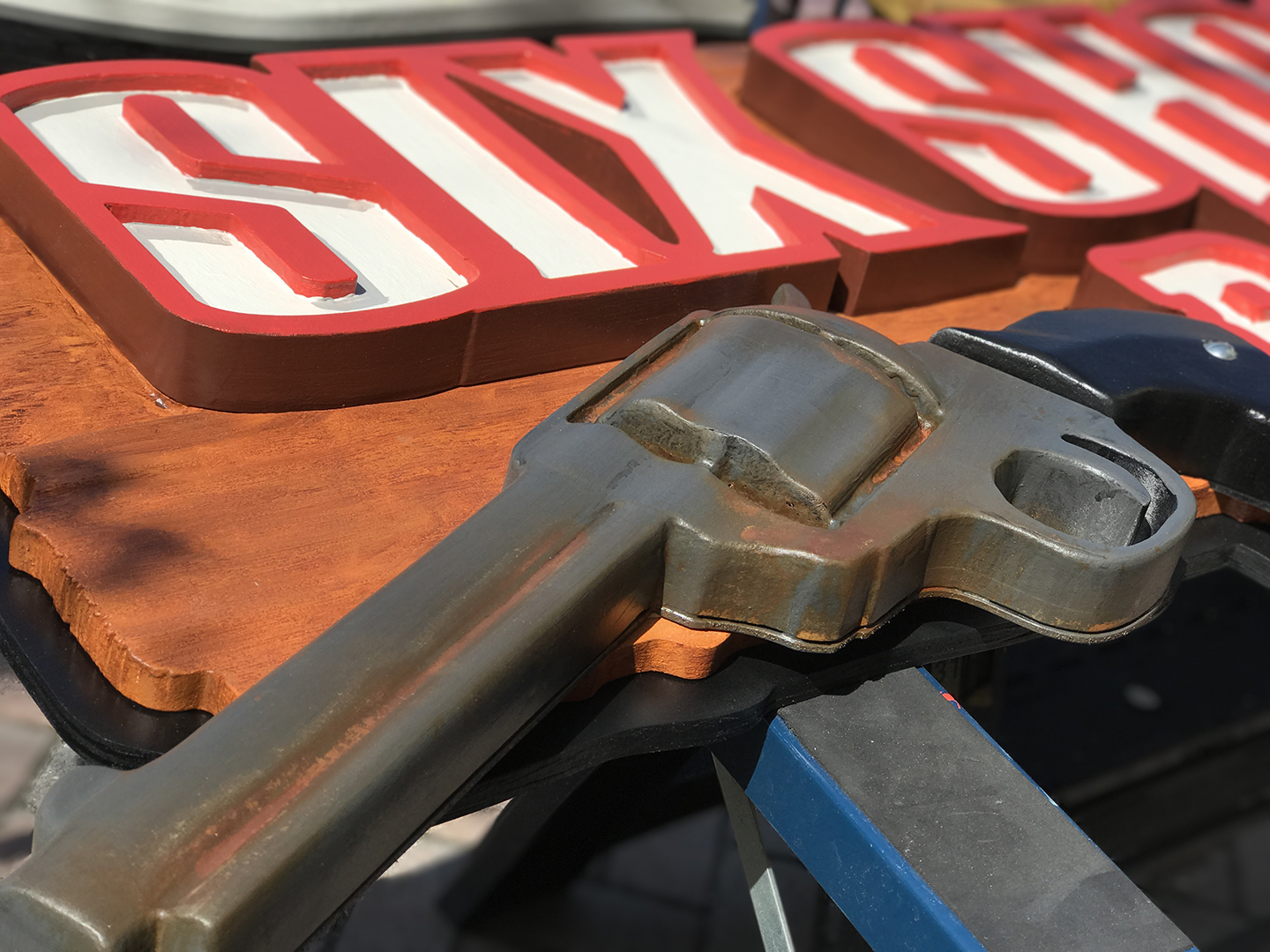

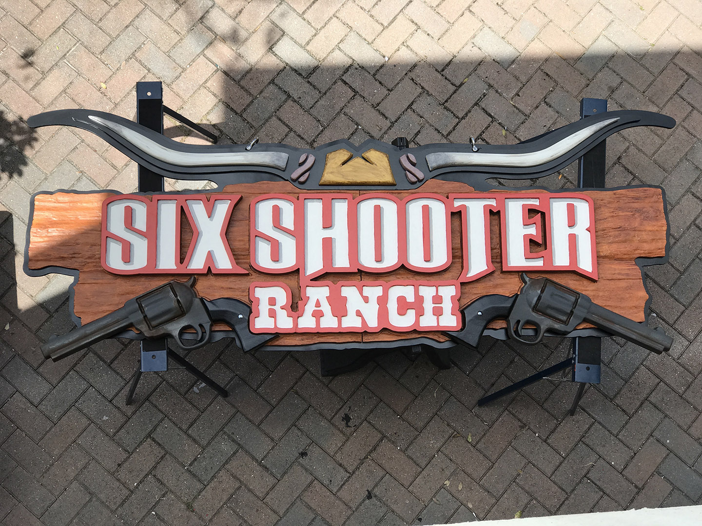

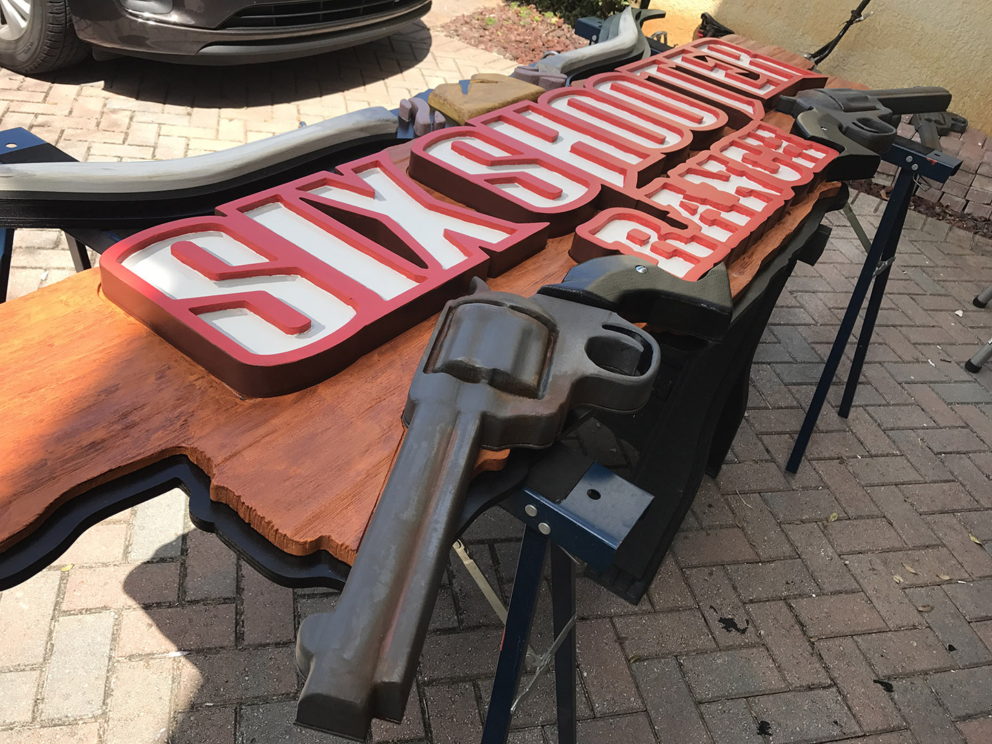

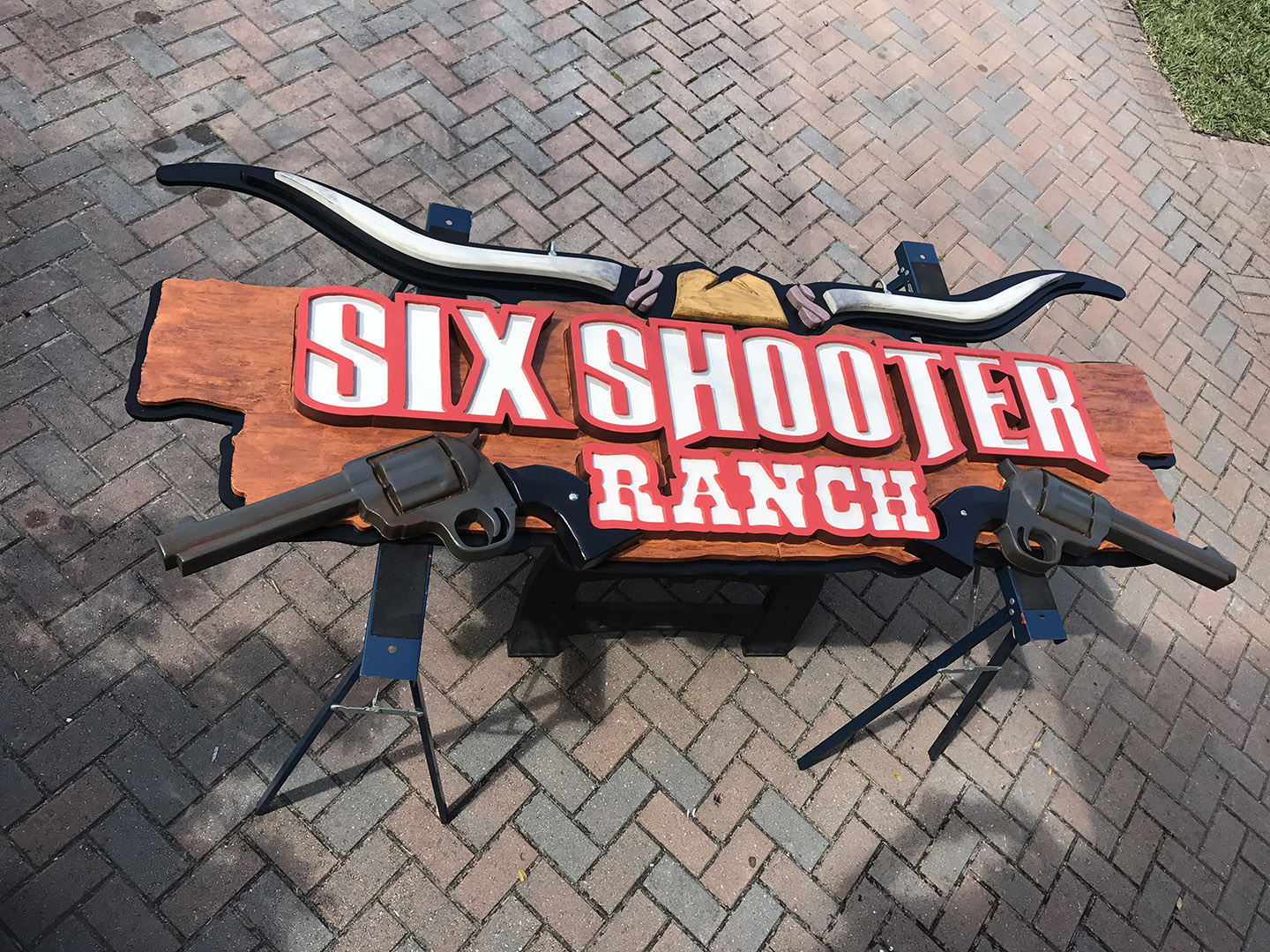

I'm just starting working with HDU to produce a few signs, I made this sign for a customer which is my first real dimensional sign. Size is 84"x32" with MDO and combination of 1" 15 lb HDU and 2" 18 lb HDU, I don't have the remote idea how much to charge the customer, just to clarify I have a long business relationship with him he didn't required a quote from me. I just need some reference. Thanks

If you never said it was your first go at it I would have never guessed. Keep making dimensional signs that look like this and you wont need to bother with printing posters anymore.

Is this going to be outdoors? If so, make sure the MDO is edge sealed good since that's the area for rot. Maybe you did, It kind of looked like raw edge painted over in one pic. And for me, I try not to do too deep of a inset letter. It will hold water and turn that pretty white green and start running out. That's if its going outdoors. Other then that it looks great for a first 3D sign.

tbullo: yes It was MDO, beside 2 coats of the black paint I coated 4 times with Minwax waterbase SPAR Urethane, I hope that was enough to seal the edges, if there is another technique to seal the edge let me know. The sign was intentional to be outdoor I guess I will be call upon to touch up those letters, I'll keep in mind what you said about the inset letters in future signs. After delivery the customer mention to keep it indoor I hope that is the case. One more question, what kind of paint and clear coat compatible with that paint to use over HDU do you recommend.
