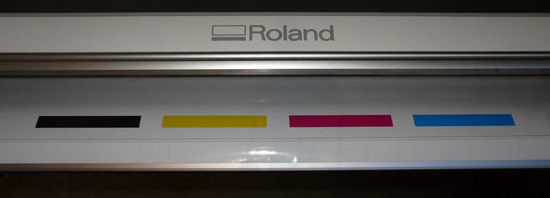

Would you say that printing off something like this would be the best thing to print on those days when the printer isn't utilized?
(1" x 8" rectangles filled with Cyan, Magenta, Yellow, Black).

Yes.I print a test print on the days the printer is not being used.Can't do any harm and keeps the nozzles firing!

I used to do that , but lately I just do a nozzle check. My Mutoh prints a strip the width of the media in all colors.
Theoretically, you could just print black as long as you havent selected "pure hue" in your production manager.

I guess I'm wondering if the pure CMYK thing I do here is better for the heads rather than some other print. (?)
If running off some of my own decals or customer promo stuff is just as good, I'd rather do that.

Well, you're certainly moving more ink through consistently across the heads by doing the color blocks, anyway, so one could argue that it is more thorough!
If you wanted efficient, than yeah, print jobs! Anything with black of sufficient size will fire all the nozzles, right?

I think it's a good idea. Here's an image of the test print I run occassionally.

In the CJ and FJ Rolands there is a test print in the service menu called fill pattern. It prints each of the six colors in a 1 inch strip the length of the media you have set up. About 24 to 30 inch wide is enough to use up the reservoir in the print head and refresh at least that amount of ink. Also is good to see if you are getting banding on a solid color.

Colin, one thing i can say about the daily routine tho.. is that printing solid bands would definitely help keep the nozzles that work - wet. since this would prevent ink from drying.
but the problem would be the nozzles that are actually clogged for one reason or another. from my experience, clogged nozzles need a cleaning cycle at the least to clear them up. that's why i personally think that a cleaning cycle at least once a day would be best. this is exactly the reason why i am so concerned about making sure that my machine is automatically doing it's cleaning when i'm not around.

I think that the automatic cleaning cycles absolutely need to be maintained, and that goes without saying. What he is proposing is a daily printing in addition to the automatic cleaning cycles and I think it is a very good idea if the machine will be sitting idle for any length of time. The ink use is nominal and the benefit could be great.

one of the best things to keep your heads viable for the duration is to print, That being said, all print shops go through slow periods where their printers aren't used for days at a time. During this time period, I've recommended to my clients to print something very similar to this on their printers.
The best thing in the world for your heads, is for ink to go through them. Personally I recommend a bigger box, about 6" x12" of each of the 4 primary colors.
It may seem like a waste at times, but think of it this way, the 3 foot of media and associated ink, if far cheaper then a head.
