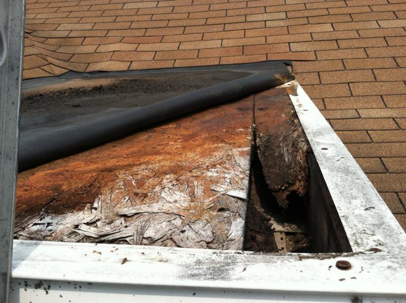

I had a contractor install a new flat roof on a very small section of a building I own. The work was done 10 years ago, and included a total replacement of the sheeting. Fast forward to 2 days ago.....I notice water stains on the wall & ceiling, so I have a contractor come to investigate. From what he's telling me, the original contractor didn't do the job correctly (apparently), and believes this has been leaking since day one.

Tar paper isn't usually used on a flat roof. Shingles just won't work on a flat or minimally sloped roof. Even if it's residential style construction, typically a flat roof would have been a modified torch down, old fashioned tar paper built up, or a "rubber type" of membrane roof like you see on a commercial shopping center, etc. Being nitpicky, he also overlapped the drip edge wrong. So it looks like the job was doomed from start if it was a low slope. If its a small roof you might not find it financially worth pursuing the guy. PA did not have a home improvement commission 10 years ago, so I don't think you could sue for the state fund on this. But I am not a sign making lawyer. As a side note... PA cant afford it, and it will probably bankrupt the state, but I noticed on TV this morning that we are about to adopt the national building codes... we're movin on up.

The contractor I had, said the truss's need replaced (what he could see were rotted), and the facia is completely rotted out also. Being the sloped roof runs into this 5' x 8' flat roof, he said he would need to tear out a couple feet of shingles, so he could run the rubber roof underneath that.
What we have are....
- a couple 8 ft truss's
- the new rubber roof material (including all that goes along with that....ice shield, contact glue..ect)
- new sheeting (plywood and insulation underneath)
- a few bundles of regular shingles
- the soffit & facia will need to be removed, and new put up
- labor.
His estimate for just that part was $1600.
Lets not forget the damage to the interior wall & ceiling. I'm only guessing, that will run a few thousand.....perhaps more, once the wall is torn out. Being it was leaking over such a long time frame, how much damage is inside the wall cavity?
At this stage, I'm thinking the best case scenario will be at least $4k. At the worst....I don't even want to think about it.
