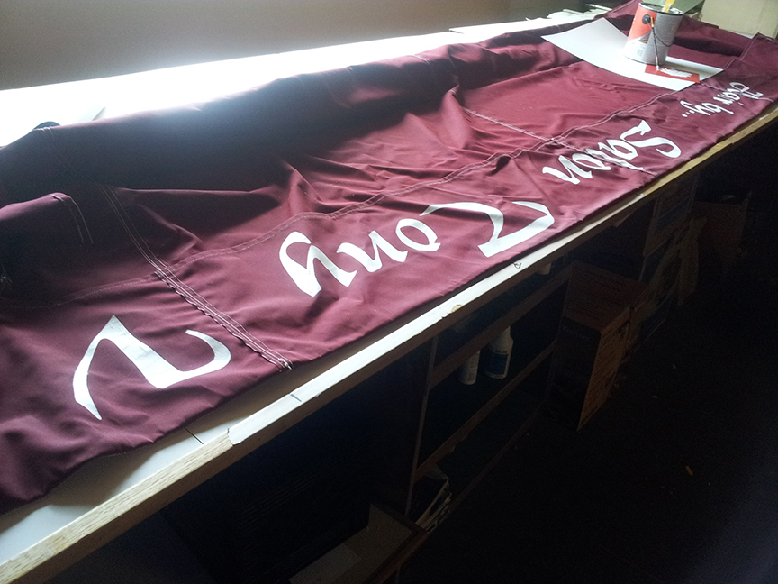

I didn't hand make the awning, but I did double coat the words on it. First coat took about an hour. Pounced it on and painted yesterday. The second coat took about 30 minutes, today. It's white latex on maroon Sunbrella. About 14' wide and 10" high, except for the little lettering. For me, this was refreshing and made for self satisfaction.

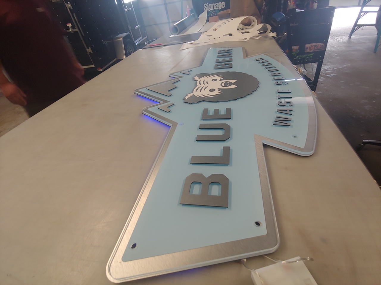

All Cut by hand, 6 layers -
Brushed Dibond,
2nd surface Clear vinyl printed with baby blue
White Vinyl for Flood behind blue
.75 inch acrylic stepped in.
more Di cut brushed metal for lettering, and glued to acrylic
Finished off with LED lighting behind & 1 inch standoffs
ok just kidding.. we used a CnC router for everything.

I enjoy lettering fabric awnings, too. especially if it's on location and I get out of the shop. That way I don't have to look at or listen to my boss.
A valance flapping in the breeze can be a problem, but if you clamp a piece of wood or aluminum behind the fabric it is not a problem.
The last two or three I have done I have used Nova Color acrylic mural paint.

If you don't mind me asking, what did you end up charging for that project?
