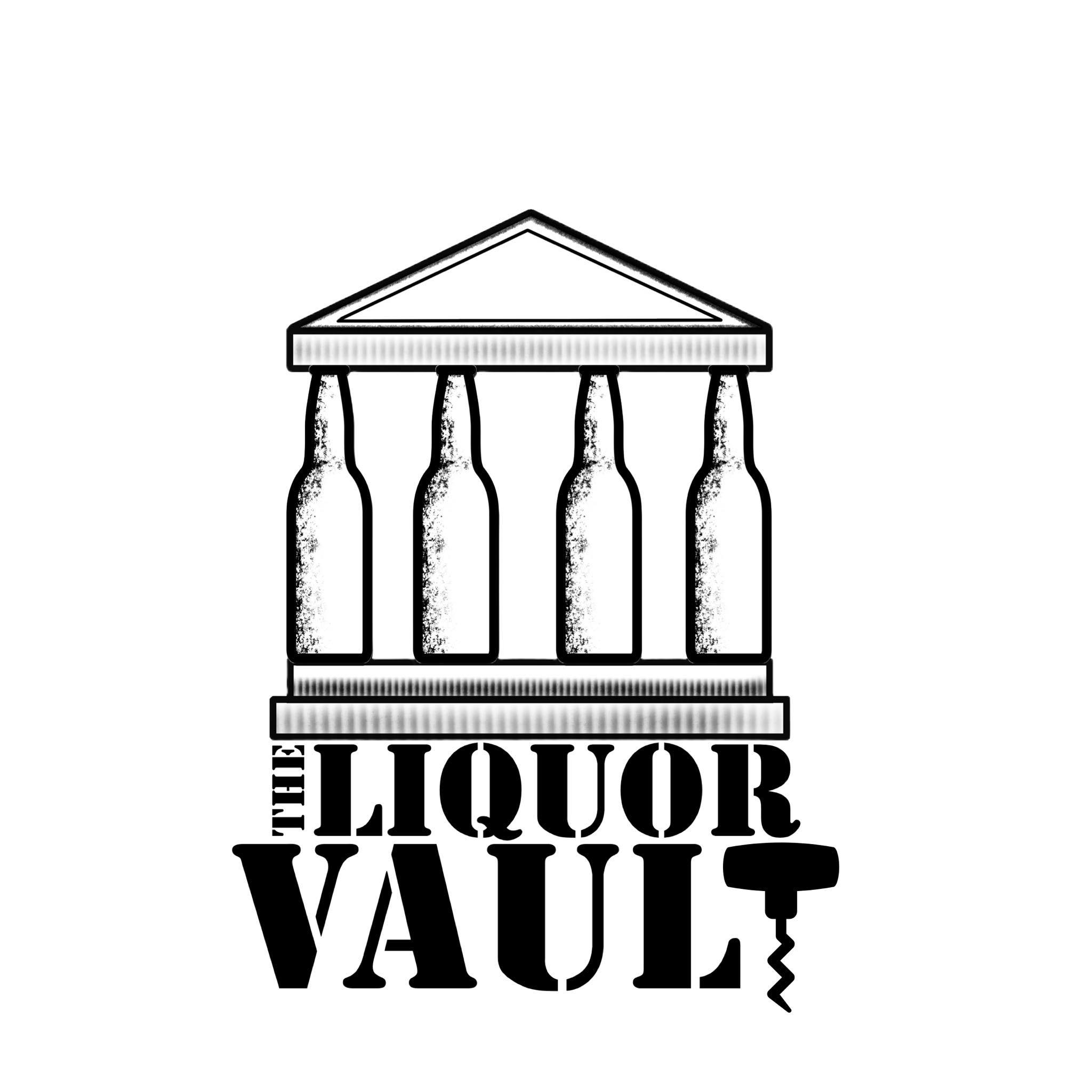

My customer has asked me if I can make the new double sided sign for his new store. The old acrylic is in the box still, just turned around so it shows blank. Each sign is 37" tall by 9' long. I found a supplier near me (45 minutes) that can cut it to size, but I have to go pick them up their truck won't haul that length. This sign is on the ground, he suggested polycarbonate or acrylic. Which would be better?
The sign itself is one color black (white acrylic is what I am basing everything on. ( My printer is not up and running yet so I will be cutting the vinyl.) My question is, I do want translucent vinyl for the logo correct? I am the one that has a printer that was shut down for 4 year to move. I am still working on bringing it back and I do have the time to do this another way if it is better to print.
The advise I need is How can I tell if I have translucent black vinyl? I moved a bunch of my stock and it was never labeled very good as I never bought full rolls of anything except what I used all the time. Is there some telltale sign that I am looking at translucent vs regular vinyl?
What is the best way to do this sign? I've attached the logo, text will be added to the sign as well. And yes the logo need cleared up.
Any tips would be greatly appreciated

There is no translucent black. You can use any black you want, but it will be easier to find one that doesn’t have a paper backer if you’re going to install it wet. Use a cast black and it will last longer.
MikePro
with that gradient in the artwork it would be easier to use a printer, but black vinyl will do just fine if you can simply convert the gradient into a halftone pattern or omit it altogether.

If sign is on the ground susceptible to damage use polycarbonate and if you want to match that logo order black print on translucent white
You are also going to have rearrange the logo to make it work on that size background

I would not use acrylic I would use lexan, there is a black translucent but it sucks I would just use regular hp black. Translucent black just doesnt look good to me
Stacey K
I like making signs
I would use regular black. If you want the gradients in there you can just send the print to signs365 on printed vinyl with a contour cut and then use black cut vinyl for the words below.

Thank you all for the replies. Customer is not picky. The substrate supplier suggested Polycarbonate as it is 10x impact resistant. The old sign I'm pulling out is acrylic. Price difference between the two is $63 per sheet. My printer is up and running again. (Thank you Jim) So would that be a better option to print it on white translucent and cover the whole piece of substrate?
Susceptible to damage, the existing sign has been there for a long time and it wasn't damaged. But it does sit off the ground 2 feet or so with a lawn on one side, parking lot on the other.
Yes, I will rearrange the graphic and I have extra text to add. It just seem awful boring.....

I'm not a fan of putting printing white trans on a white sheet. It always seems to make the white look gray.
I'm also sorta picky, so... you'd probably be fine.
I would definitely go with polycarbonate.
Not just that, it literally cuts down on however many foot/candles the sign is emitting. Print on clear for best results.
