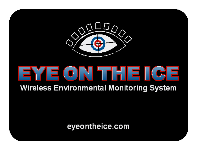

Hi All,
I've been trying to export proper JPEGs of jobs I've created in Omega but, despite the jobs being made entirely of vector graphics, JPEG exports, no matter what size I specify, come out jagged, like the previews in Omega do. Some customers complain about the sketch quality because of this. I would expect that the JPEGs would come out anti-aliased, but they don't.
Does anyone know if this can be adjusted? And if so, where is that option located?
Thanks.

In the "export" window that pops up in OMEGA, there's an options button... but I click on it, and it does nothing.
I find that exporting, and then scaling the image down seems to be the only way to do it, which is fine for larger pieces. For smaller items, I've found I actually have to scale the items up in composer (usually about to 12" wide), then export at 300dpi, then scale it down in photoshop or whatever to get rid of the "jaggies".
It would also be nice if the export function had an option to process the file as seen in "output view". It's pretty annoying having to go in and get rid of bleeds, overlaps, overprints, etc... so that the proof (or paper print) I send to the customer looks alright. In most cases though, I can just print screen... but then I still have to go into photoshop, resize, crop, etc...

Bill, it becomes even more of an issue when you have small text incorporated into the design. Small text comes out looking great, but the customers logo looks "jagged". Try getting them to sign off on that. Attached is an example.
