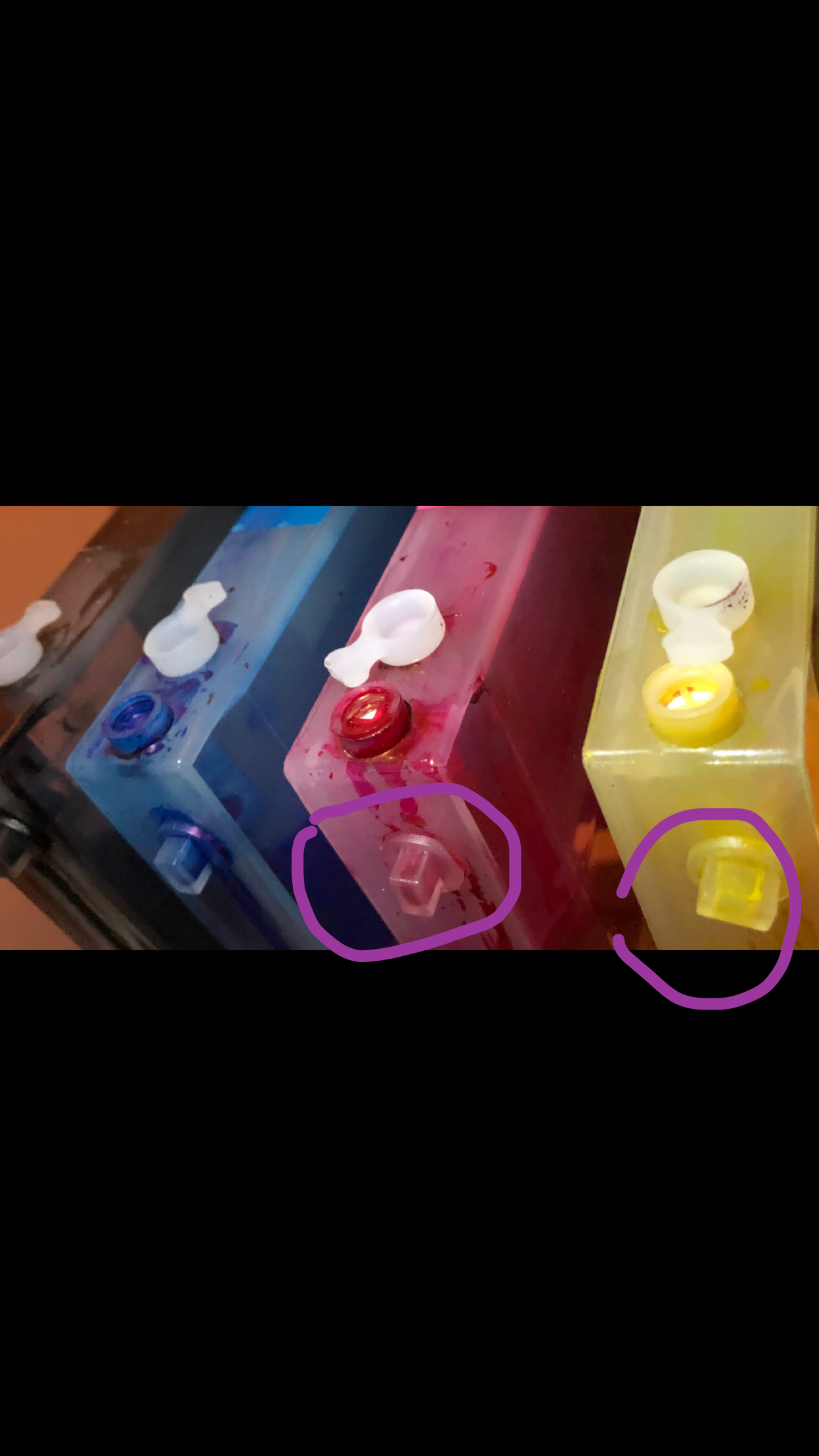

should there be pressure in the system for the paint? when I removed the "little things" (attach picture) it sounded like you were opening a carbonated drink, with them on it felt like the paint was pulling away from the dampers, and with them gone I got paint directly when I used the syringe.

It shouldn't be pressurized. A normal cartridge has all of the air taken out which makes it so it doesn't pull back on the system as the ink level drops. Refillable cartridges like yours should have a small hole in them to allow air in so that the same problem doesn't happen. Maybe yours is clogged? Try running it with the plug and see if that helps at all.
Johanswe
after I removed the plugs it worked really well. find no hole for air on these, if it is not the things over the plugs that are air intakes?

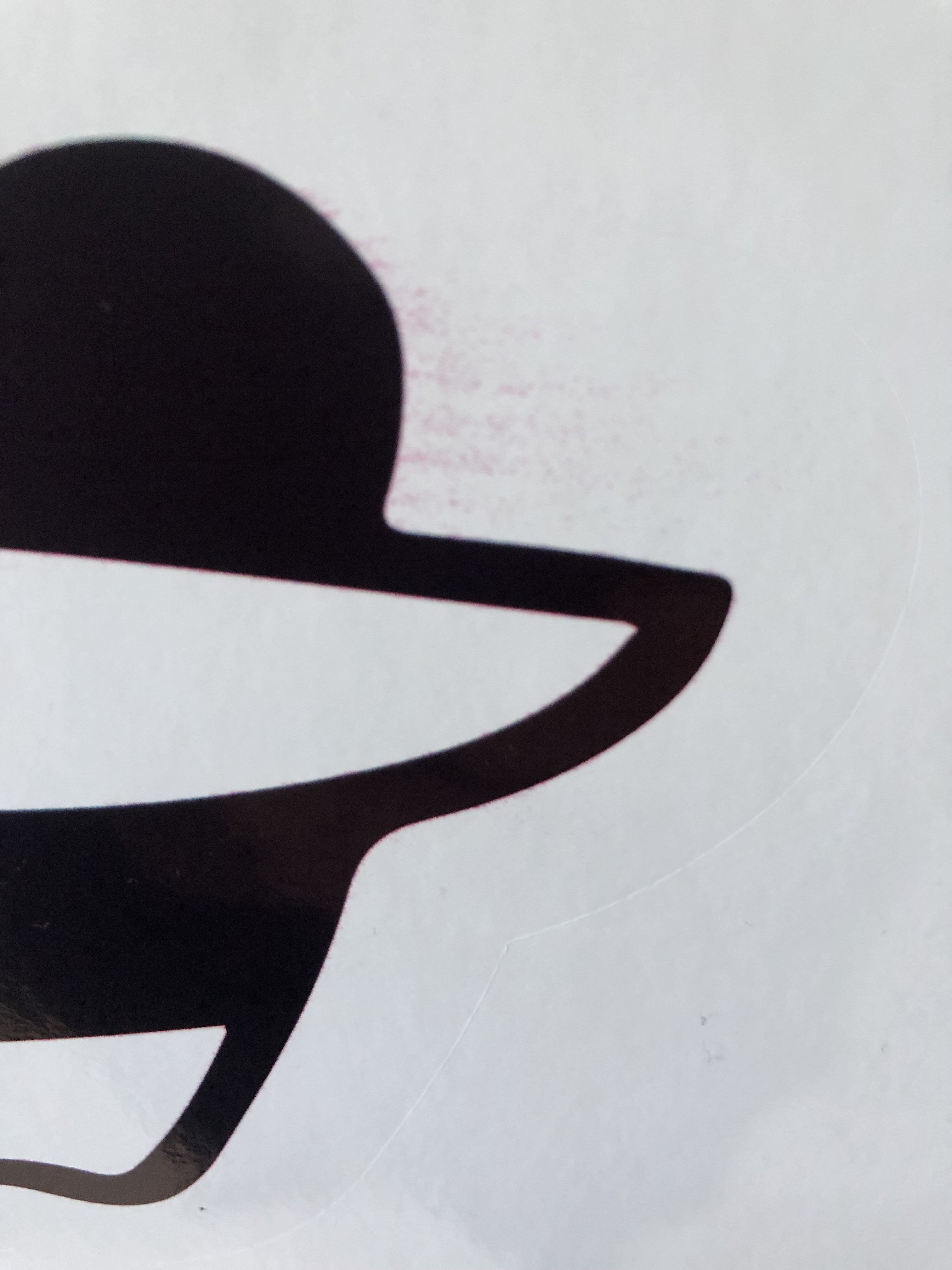

can you help me again? 2-3 months ago my roland started making a red line around the decals. head alignment is still good.
the red "line" on the decal only EXIST if I make a black square or black text.
for example, if I make a yellow or red square, there is no red line. I post a picture below.

Did you replace the caps with Roland OEM caps? This should be your very next step.
Eliminate debris by checking underneath the head carriage for anything hanging down. Does this only occur in areas of heavy ink coverage?
Because appears it is only magenta, I don't think it's debris, but the magenta channel of the head. Do you know how to get into service mode? If so, go into the service menu - test print - fill test. Observe how it prints, watching the passes as they print. Also, look at the edges as it prints. The edges should crisp, even and clean. If you see any back and forth movement of the image, then your bidirectional alignment is off. If you see overspray like in your prints, then the magenta channel is probably going and you will need a new head. But do the first 2 things before buying a head.

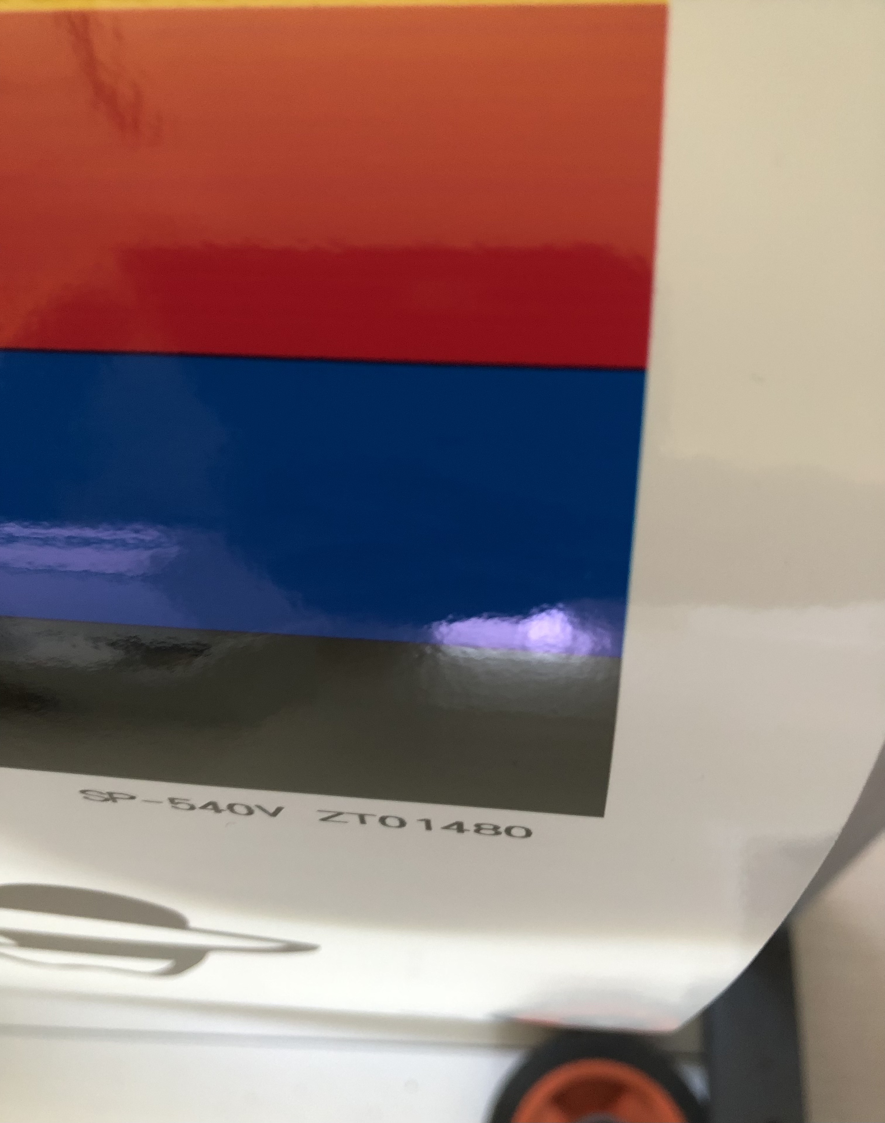

hello! I have made some squares with black, blue, yellow, red and it looks the same on the red squares. but I will test in service mode when I will use it next time. THANKS!

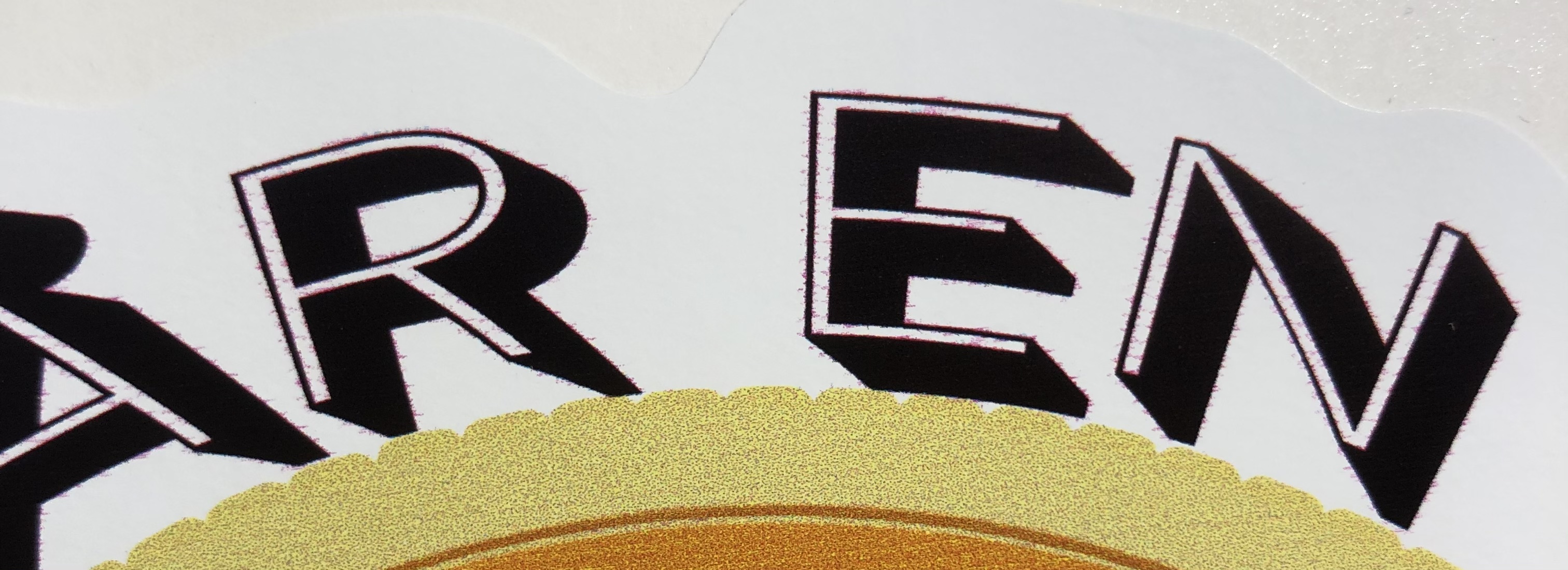

I have two decals that are almost the same, the difference between them is that one has a black background and white text, the other has a green background and white text. the one with a black background is filled with magenta and the green one is nothing. (it is the white text that has magenta in it)
some days there will be nothing and some a lot.

not oem capps.
Made "fill" in service mode now and it's like the decals on the red.
And it is in line with the other colors.

Bad head. Fill test is the definitive test for printheads on the Rolands. It is the same as printing in Standard mode of most Roland profiles - 720x720, 8 pass, standard speed, bi-directional, 100% ink output. This is where you are able to see each channel's behavior under normal printing conditions.
