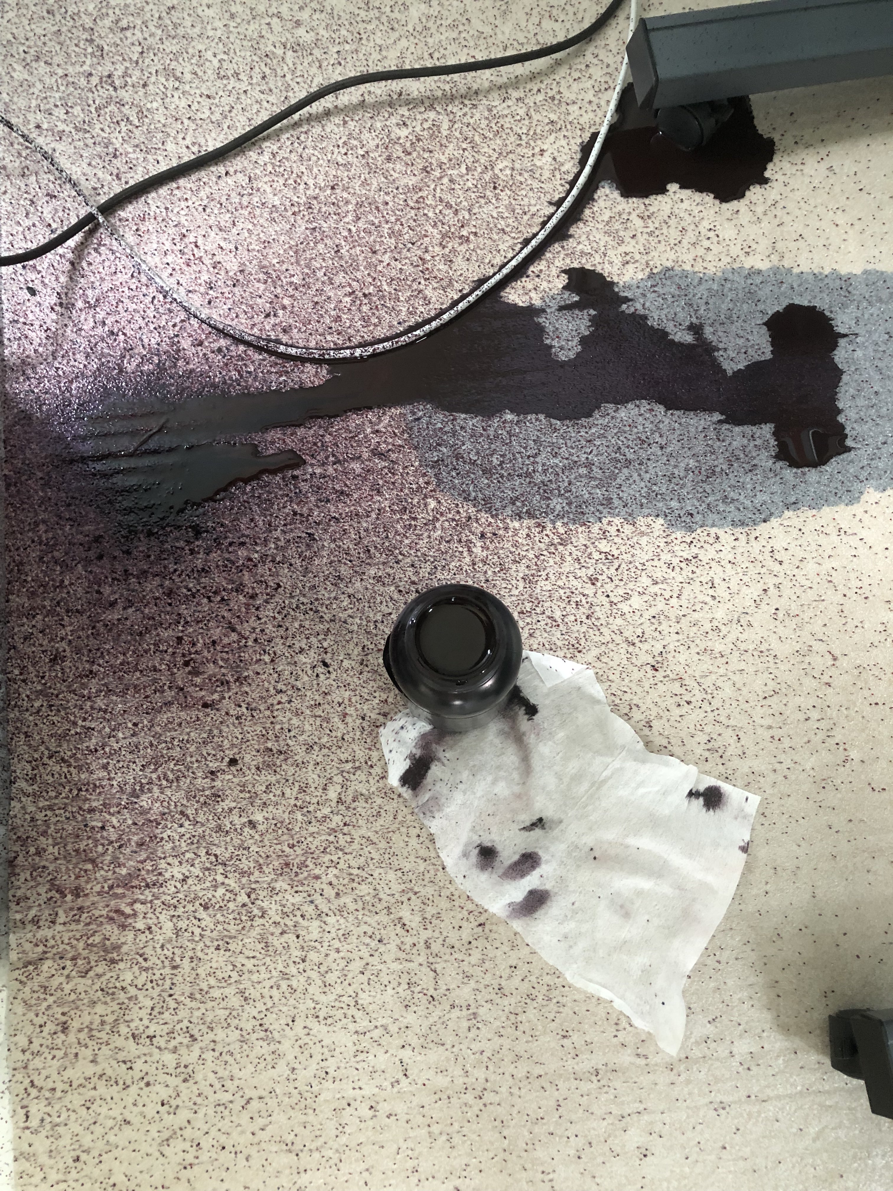

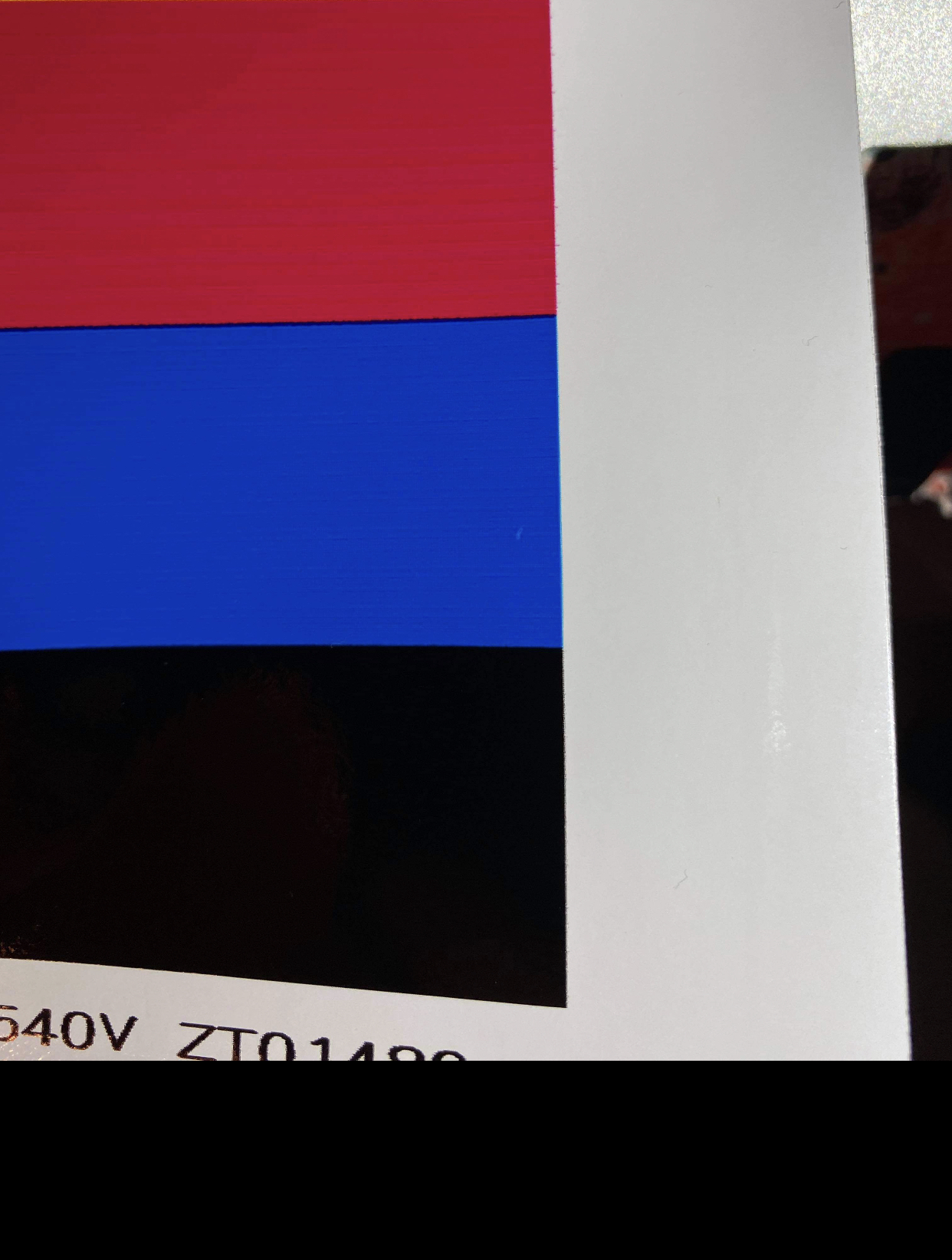

okay. I send a picture of the fill and one of the decal. the lines on the fill are barely visible in the picture.
Johanswe
Johanswe
today when i came to the machine it looked like in the pictures. all paint has been sucked through the machine .. what is wrong?

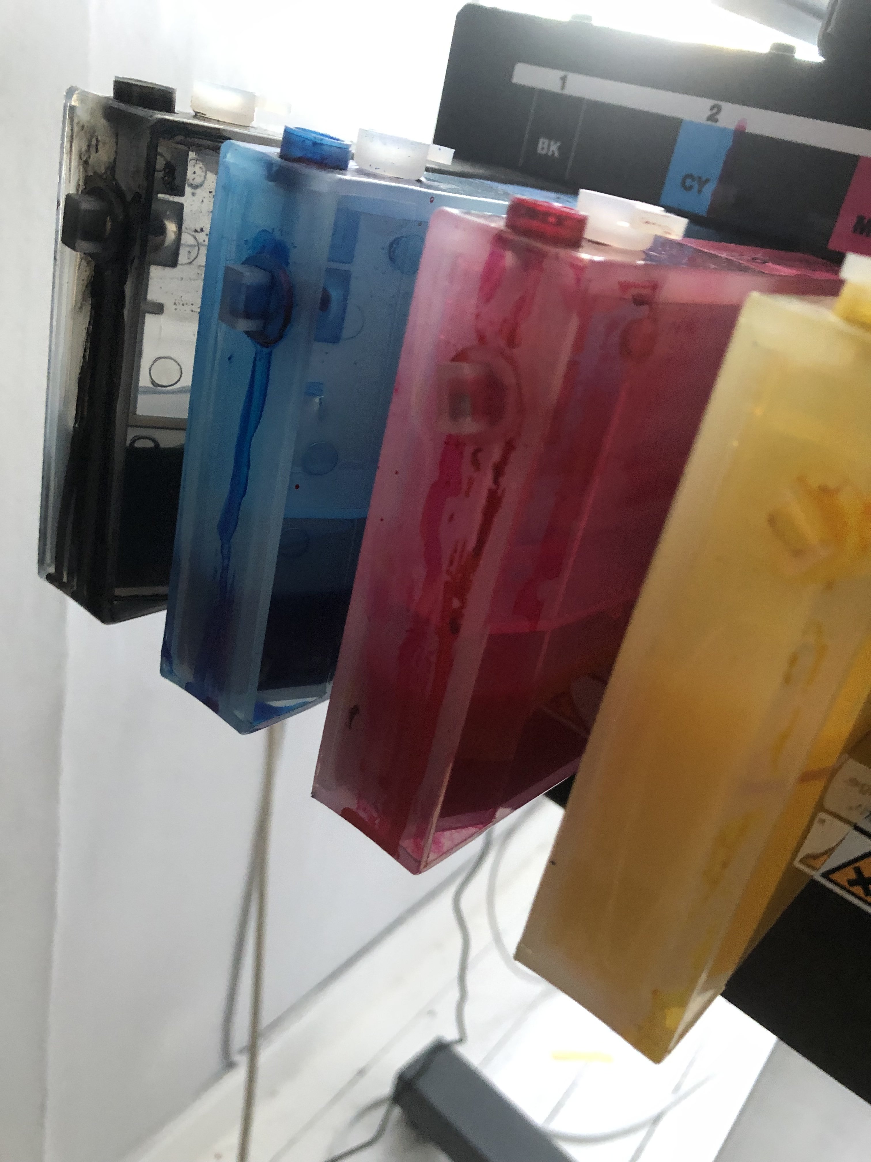

Jim Hancock
Old School Technician
Remember when it was suggested you use OEM caps? The inner white part of the aftermarket caps probably swelled up and touched the bottom of the heads and wicked out your ink.

Rap Master
I may be wrong, but I believe you damaged your Magenta head pushing/puling too much through them when you had the last problem, now you're getting overspray on that channel. I think that issue was a bad pump or cap seal; these printers don't have pressure in the lines, just suction from the pumps.
The reason it appears on "black" squares and not "green" is because the black is actually a "rich black" which includes magenta (and all colors) in its color, whereas the green is only yellow and cyan. I haven't used VersaWorks in years, but can you look at the color breakdown in the RIP? It should show you that the black area is actually made up of all colors in this case.
