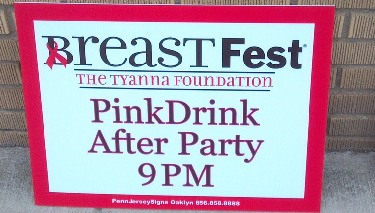

I just ordered pink signs from signs101 and the border came out red. The pink was damn near glowing pink in my artwork. They got the pink in the text just not in the border.
Who would you use if you need colors matched on digital signs?

Because we output tons of other folks files, I can say with 100% certainty that color issues are 100% dependent on the file submitted provided the vendor has a solid profile.
Many times a "bad file" it's not even caught on the customer side-they may have an older monitor that renders weird, lack the proper PMS pallettes, set up files with CMYK and RGB mixed, have colors that look the same on screen but are defined differently, etc.
I don't know if we printed the above sign, but I can guarantee that if the printer has the ability to hit the pink in the type, it has the ability to hit the pink on the border provided it's given the proper information in the file. I'd bet that if you eyedroppered the copy and then the border, it's a different color all together, and possibly even one CMYK and one RGB.
Whether it's us, S365, 4over or whomever, unless you prep your files 100% using PMS swatches (that you reference to a swatchbook, NOT your monitor) or you have a perfectly calibrated monitor to your vendors systems, there will always be some color variations. It's inherent in the process.
As vendors, we can get close, and in our case we either do, or have schooled our clients to improve file setups for better color.
If anyone wants to ask a file prep question, I'm happy to help (even if we don't print for you).

We hope you continue to use us. Make sure that you provide a PMS color match next time you order and we will match it as close as possible. In this case, your artwork was fine...you chose our color vibrance option,which wasn't necessary, causing the pink to be deep and red in hue. The thumbnail changes when you choose color vibrance to show you this change. As you know we have reprinted the signs for free, with a color match, and have also overnighted them for free for you as well. You will be receiving them tomorrow and should be satisfactory to you and your customer. Thanks again for your business!
