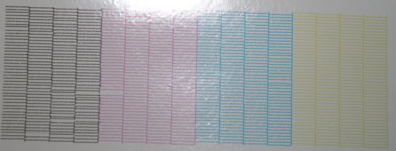

1) i have a jv3 130sl (using es3 gen inks) Everytime i print anything with black i see a fine mist of black inks spray around the object or letters.Now i have attached a test print for your review.I have also seen this spray in blue as well.
I have soaked the caps for 10minutes at a time with no improvement.I have only had this printer for about 3months as a second owner.
Can anyone advise best action ? Is this a sign of new heads required?

You should take a picture or scan of exactly the problem you are having. You may clear up your problem by simply performing the Maintenance Print Adjustment. It could be the deeper level (#) calibrations or you may need to replace your print head.

Soak the heads for a couple of hours, then clean cycle, test print. If it isn't good then do it again.

Thanks for the detailed feedback and apols for the late reply.ES3 Eco-Solvent inks are what our Mamaki authorised agent recommends for my JV3 130SL and it has been used with this machine since commissioned 2 years ago.
Just to keep you updated i have now replaced the black head on my JV3 130SL with a new head from Mamaki with a vast improvement with the over spray issue now disappeared.Print quality is better than ever although i have a grey scale color issue which i will open to the group to see if other JV3 owners have crossed it before.
