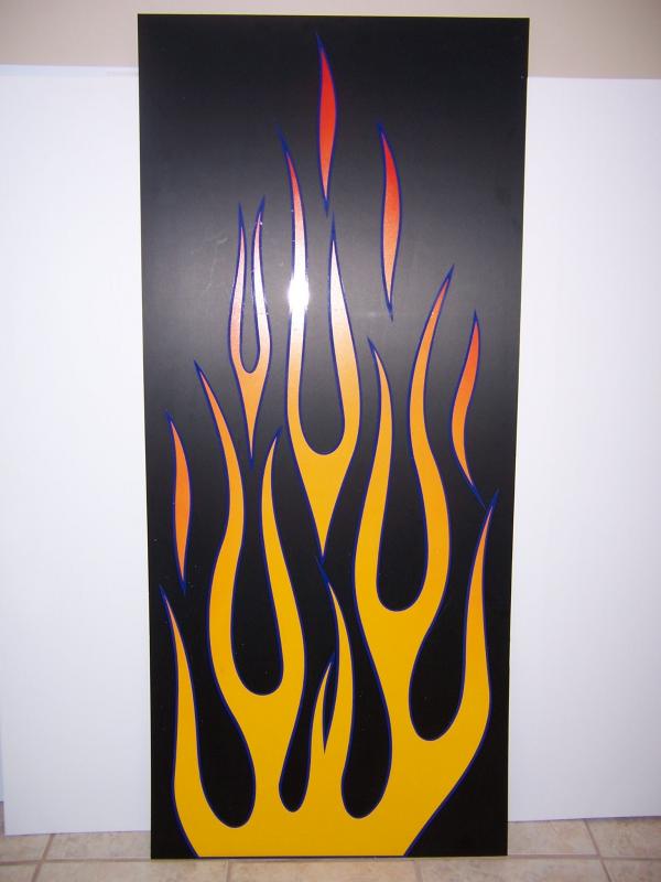

4x12 banner, customer wants some flames on it, and i thought about cutting yellow vinyl and spraying some orange and red on it to get the gradient effect of flames
AUTO-FX
ya mean like this? krylon on oracal 651.
Use the Krylon for plastics and paint the vinyl first. Once its good and dry..... cut it and weed only when you are ready to put it down. Try not to use application tape. It sometimes lifts edges.
