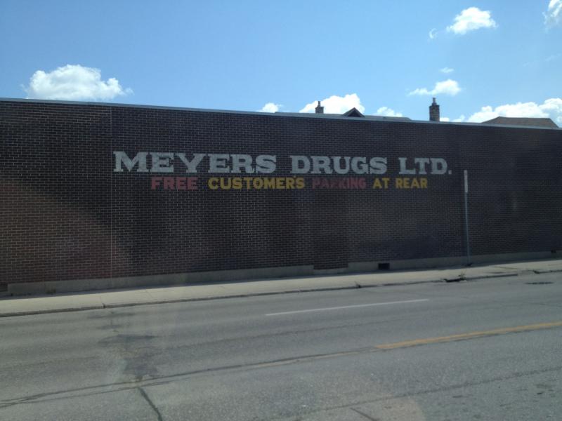

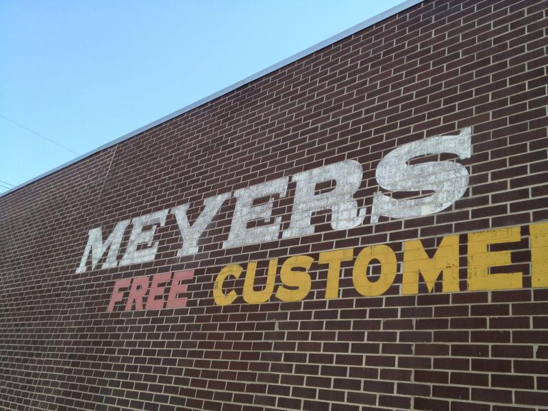

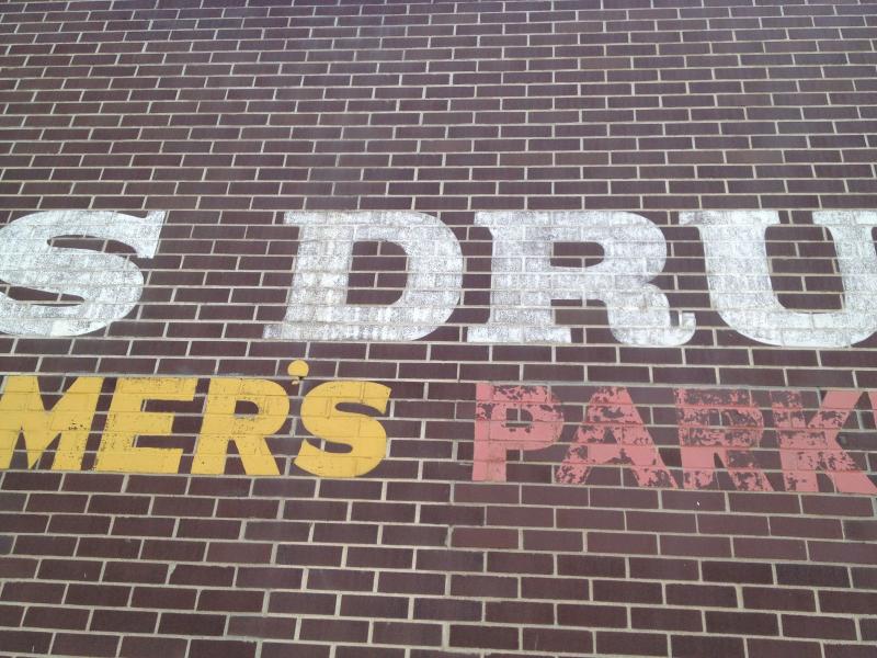

I have been asked to re paint over some old painted Letters on a brick wall, and wonder if I could pick up some tips as this is a little out of my experience!
Wire Brush the old paint off leaving enough to use as a guide, Clean wall, Prime With Latex, Paint With Latex, to seal or not to seal?
Client would like everything just the same just repainted. Brick and mortar are in good shape. 36' x 36"
Any advice would be helpful, thanks in advance.

Note.. try to change the bottom copy to all yellow to read better or at least to read
__customers parking at rear... instead of __customers __at rear

After 40 years of painting walls on at least a monthly basis, I would suggest after wirebrushing the copy to seal the copy with a clear transparent masonry sealer. this will prevent the chipping you see taking place on the original and act as a clear primer,...
