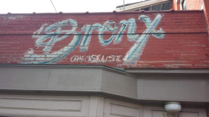

I'm trying to post a pic but I'm on my phone, lemme try something

Oh, hell, that thing isn't even worth saving. I'd make a new pounce pattern and redo it in a less graffiti-like way.
The method Gino described is this: Clean the wall, go over the design using a sharpie. Paint over it with Ronan Block-Out white primer. Hopefully the sharpie will belled through, creating a template for you to paint. In this case you would cut in with the background color then do the lettering.
You have to be careful to use just a thin coat of the block-out white (roll it on) because if you go too heavy the marker won't bleed through. I discovered this at 70' in the air one day. But as I said, what you are trying to save isn't even worth saving. I'd start fresh.
Totally agree. That monstrosity is worthless. Knowing your business is one thing and helping customers is another, but to take on a job like this is a disaster..... then you wanna refurbish some windows....... ??
Talk them into something a sign person would be worthy of doing, not that mess.

Jill, thanks for the help and the clarification. Yeah the logo in that pic is crap. What do you do when someone comes to you with crap and they ask for you to help not make it look crappy anymore? I like lettering and I get it when you guys say sometimes the customer doesn't realize how ****ty their job is but do you guys normally pass on this work? Seems like there are a lot of crappy signs like this.

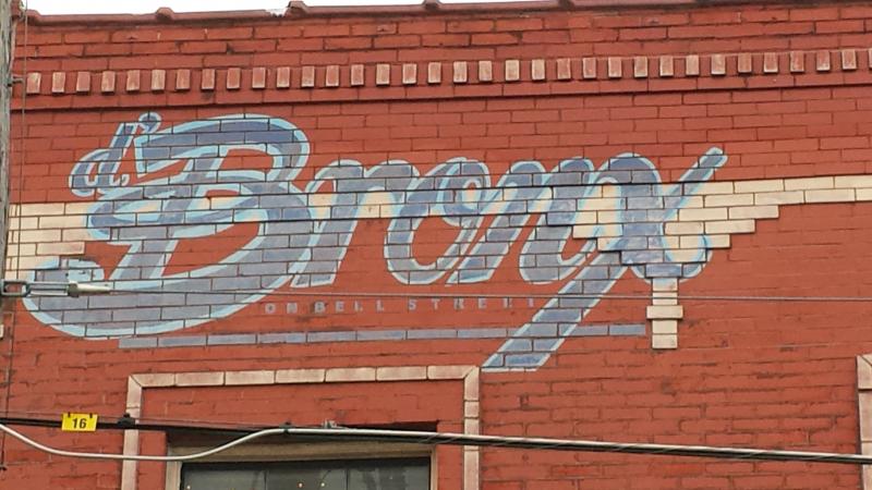

Here's a pic of one of the other logos that they naturally want the one I'm working on to match. Thoughts?

Those are not as bad as the one that you first posted. You're going to have to make a pattern from the cleanest logo you can find and go from there.
