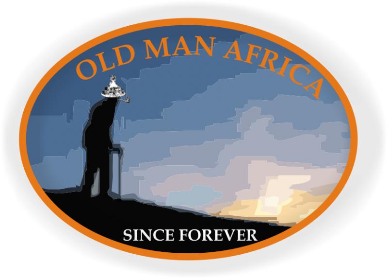

Guys,my client ask to design new logo. He call himself "Old Man Africa' and he do 4 x4 tours into the bush,mainly Lesotho.He travel all over africa and take tourists with him.This is what I came up with.

•Arc is not right, upper and lowercase does not look right
•Since Forever is too squeezed.
Nice touch.
If you are locked into these components, I would move the man closer to the center so his head isn’t decapitated by the copy and I would use a more contrasting color for the copy. I would also move the copy closer to the center and finish the edge off with a border of some sort.
I would also try placing your secondary copy in the lower area of the sky and not arch it at all.
The background of the sky looks great. I really like that effect.

What Mosh said. And I don't see how it conveys anything about what he does. Sorry!
Sorry..I should have explained.He takes tourist to a very remote area of Africa.The man you see is a typical 'Basutu" wich is a tribe in Africa.The hat is theit traditional wear and you will often find their elders look over the horizon at the end of the day in a spiritial gesture.

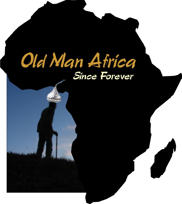

A suggestion, don't stay locked into the oval idea. Find a black silhouette map of the continent of Africa and work in a reverse image of the old man walking. Design the lettering to fit within the profile. I can see it in my head already and I think it would represent the intended purpose better. Give it a try.
I decided to just show you. My point is think outside the box and make sure it conveys the purpose if you have to use a graphic.
Yes that's a Hersheys kiss on his head.

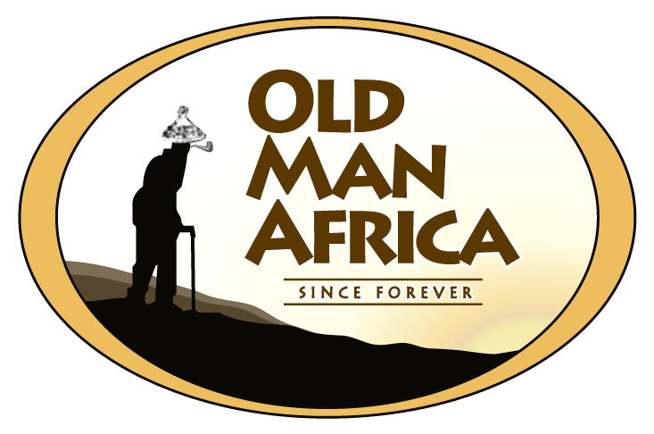

I really like the old man silhouette gazing off into the distant sun sunset. However, I would change the colors so that there is a much stronger contrast. I think that I may exchange the arced text for a left justified stacked text placed to the right of the old man. As Gino suggested, I would move the secondary copy out of bottom foreground into the sky just beneath the main text.

This is amazing. Thank you so much. How do you feel about me using it? Please let me know.

Great makeover man!!!:thumb:
