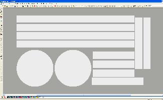

So, I had some time to kill. I wouldn't have posted, except for what my final result was.
Fellers sells the 3M 680 in 30" rolls. 50 yard for about $1200, let's say $24 per yard. Quickly laid out, you could squeak all the vinyl for one car into a 30" x 55" space (I'm sure with doing a 250 cars, you could come up with better layouts than attached, but the "waste" would be minimal).
Do the math however you want, but:
250 cars x 55" per car = 13750 inches, or 382 yards.
382 yards x $24 = $9168
$9168 / 250 = $36 cost.
Double it = $72
I hope to hell this isn't how someone came up with the pricing (it doesn't take into account the printing of the seals, premask, labour, or blades, blades and more blades), but I have seen a lot of "newb" shops double up their cost of materials and figure they're making bagloads!
PS. 250 cars per year sounds like a LOT. You sure there's not an extra zero there?
PPS. Just realised this wasn't in the premium section. Mods can change my post as they see fit.

Thanks to everyone for the helpful replies (especially Browner). It didn't seem like a job that I would be willing to do anything with, just seeing if I was doing something wrong.
Browner, I'm positive it is 250. They use quite alot of the sets, and whatever they don't use just gets put on their shelves and eventually used. But thanks again to everyone for the help - this one is a no go!

$36 to cover labor (sales/design/production/packaging) Misc materials, Fixed costs, and nothing for the machine time....sound like a plan for bankruptcy
