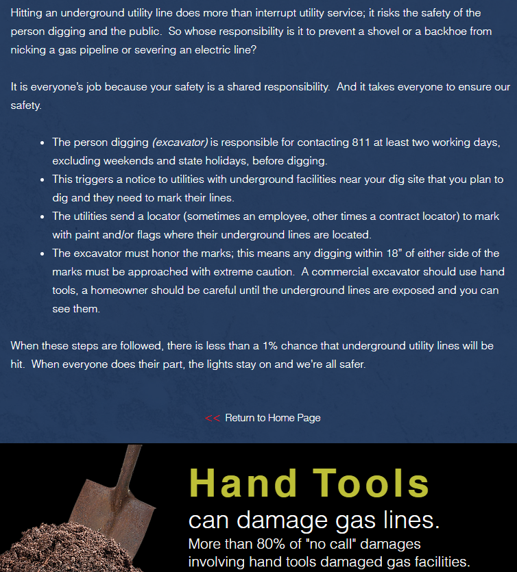

never heard the clause about power tools, I have been told any digging requires onecall!
Same here in Texas - if you dig, you should call.

For CT it is required with mechanized equipment only.
Where my brother does the same thing in NJ, he is supposed to call for every hole.
