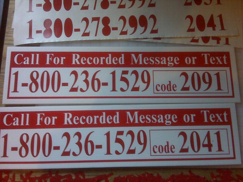

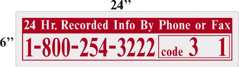

Question for both Fred and Bill,
I would really appreciate your opinion on the Gerber for my application. I have a niche product producing a sign rider that is 6" x 24". About 95% of the signs produced are red on white but we also do blue and black. The sign is screenprinted except for the toll-free number and extension which are cut vinyl. I sub out the screenprinting. The printed area is 5" x 23" and the signs are double sided. So with a printed height of 11.8 inches on the Gerber I could create two decals for every 24 inches of vinyl. Using third party suppliers as Fred suggests it looks like the spot ribbon will run about .40per linear foot and about .33 per linear foot for intermediate vinyl from LG. So I would be looking at $1.46 to produce the two decals I need for both sides of my sign. Is this correct or did I miss something? Thanks for your help.

You are correct.
