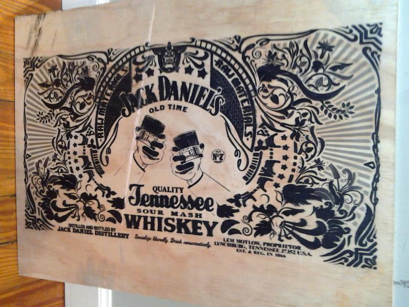

woodtest.jpg I actually tried this tonight in the direct to garment printer. The wood soaked it up and it bled. They do make a non-textile pretreat for this though so I will give it another go. This is one of Pat's files that I inverted to make the text black. Just a test run but it will be nice once I perfect it.

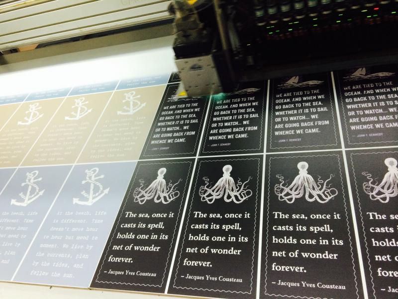

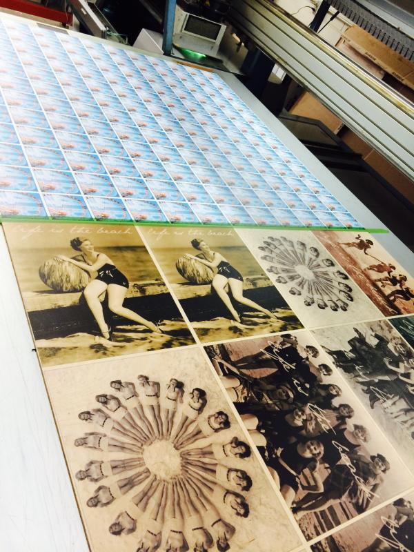

Flatbed printing on wood to the trade
We print on wood–painted, whitewashed, clearcoated and raw. Here we are printing for a shop that markets these for retail sale. As long as its a decent quality panel that is flat, it works quite well!
