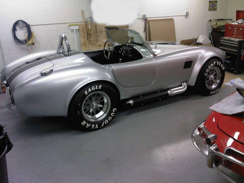

Putting the stripes on a Cobra tonight. Any tips?
signmeup
NO, look like it would be fun to drive!
I meant intimidating to stripe. Actually it's intimidating to drive too. It's got almost 500hp and weighs a thousand pounds less than most sport sedans. Fun for sure but you have to be careful too.
signage
That is a newer kit car correct?
If you think that hard to control imagine what the originals were like! Suspension no were what that has under it!
signmeup
The car handles like a dream. It's the insane power to weight ratio that us mere mortals have to get used to. As I recall there were a few deaths in these things back in the day. You plunked down 6 grand and they handed you one of these... whether you could handle it or not. You can get into a whole lotta trouble real quick.

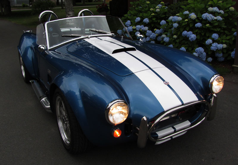

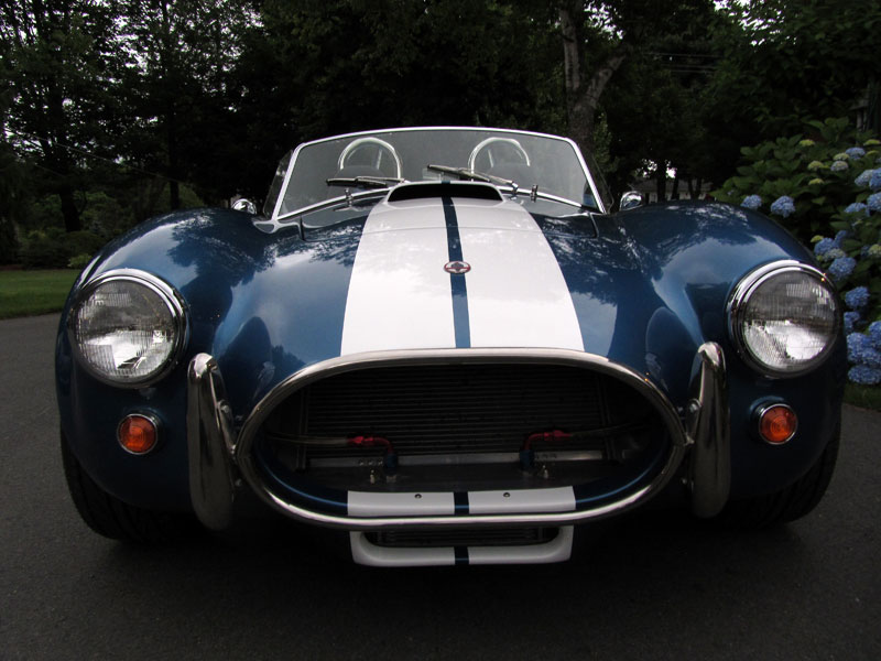

Here's the finished product. Came out the dog's bollocks!
I was right... the hood scoop was a bitch.
You should hear this thing. Makes the hair on your arms stand on end!

Very nice!
I like the way you matched the flowers to the color of the paint.

Looks awesome from here!!! Really good job :rock-n-roll:
When I did stripes I taped mono fishing line from the front bumper to the hood, over the roof, down to the trunk to the rear bumper to make sure I kept the lines straight. Once you have the stripes where you want them just move the mono out of the way and apply your vinyl.

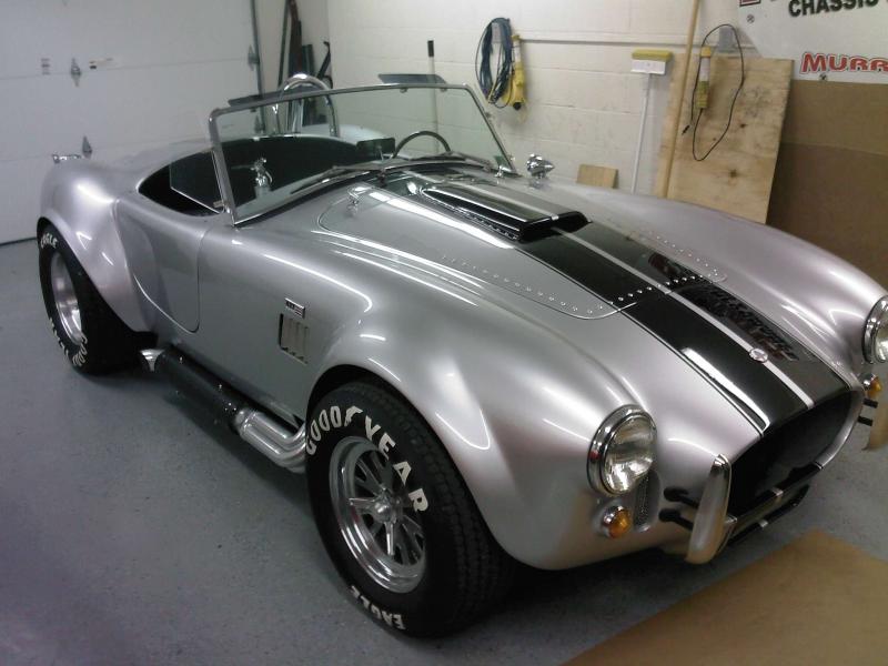

Looks awesome!, not something that I would look forward to starting on but definitely one to be proud of!
We did one that was really similar to that several years back...but we painted, cleared, then wet sanded and buffed. Almost the same color even.

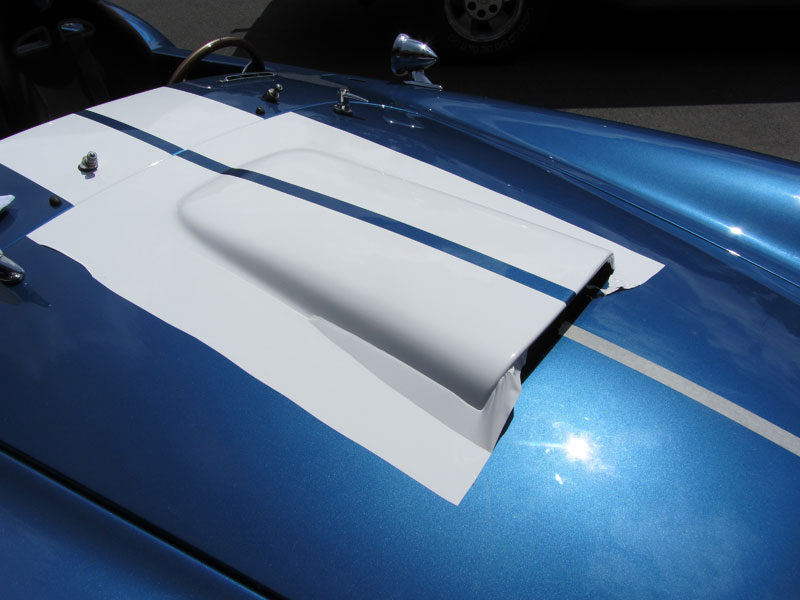

How are you guys doing stripes over a scoop like that? Like where do you cut it so it looks flush with the scoop indent and all?
signmeup
Here's how I did it. I think I could do it in one piece if I used air release vinyl but with Oracal 751 I ended up with a 1/2" seam at the front edge of the scoop on each side.
The excess width of the stripe was cut after the scoop was covered. Eat a banana or two before you cut on the car!
