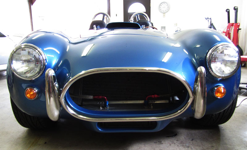

I'm putting the traditional double stripes on a 66 Cobra replica tonight. Looks a bit daunting around the trunk and hood scoop. Any general tips on wide stripes would be appreciated. The stripes are 7" wide and an inch apart. I'm thinking I will be cutting some sections on the car. Do you apply any of it without mask? I'm using 751 vinyl.

Nice new paint. The body was removed for painting so as not get any overspray on any of the drive-line components. Not a mark on it. No pressure...

Here's a before pic. Intimidating isn't it? The hood scoop is a bitch. I'm putting on dual 7" stripes 1" apart.
