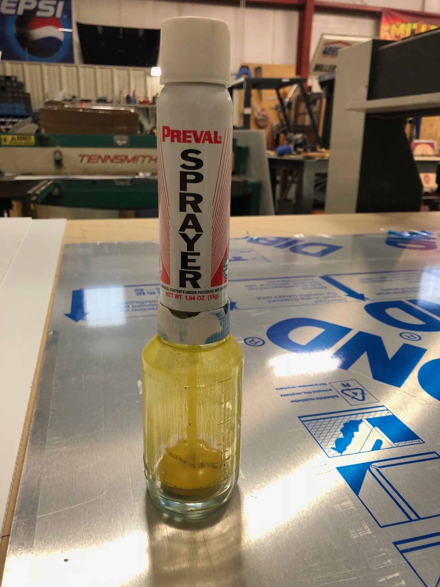

If it's not all that bigga job, you can buy home-made rattle cans (but they're glass, not metal) at Home Depot or Lowes, have them mix your paint, put it into the bottles and spray away. They're called Preval. It's a canister of compressed air and a bottle......... and cheap. We have many of them here at the shop. They don't spritz, drip or spit. Does a very nice job, with oil based, latex or acrylic.

When we need a specific color for routed pvc letters we go to our local Car Quest and get them to mix the paint for us. We use automotive paint that does not need a catylist and we use a Preval spray system for small jobs. Super nice finish. If the color does not have to be a perfect match we use Krylon for plastic spray paint.

There are also local Sherwin Williams paint stores that will match and mix paints for you. They also carry the Preval Spray cans (or guns) that will hold up to 16 oz of paint (Gino mentioned previous post).
