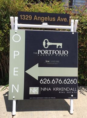

Several vendors carry these on-line, but on an order of 50 pcs, I hate to just ship all that in & struggle to squeak out a little profit. Maybe i can make some money throwing together some of these, but I don't recall ever reading about who here has done that.
I think I've seen them as low as $17 without the sign blanks, but shipping all that bulk out to Hawaii might easily double that figure, and that's before mark-up!! Now I know why I'm getting a call from a big realty firm for a big order, but they haven't called me in years... probably didn't like what their regular guy has to charge!
Oh yeah, he wants to attach riders too...

What would keep them from blowing over ?? Or just falling if someone bumps into them. They aren't anchored in any fashion. Without the extra weight of metal stands, this doesn't make sense.
Billct2
Yes, those could be fabricated in house fairly easily. I agree that they will blow over, but you'd probably need steel pipes to make them heavy enough.
Sand in the pipes is an interesting idea. Or some kind of folding base that could be weighted would help too, that's what we usually do. But of course these are for a realtor so
any extra cost will kill the job

I have some "made in Canada by Smart Design Ltd. pvc hinges made for making sandwich boards. I do not know where I got them because I purchased a box of them years ago. You just cut 2 1/2" thick PVC boards or MDO. With cut out feet and attach these hinges to the top. Put a cross piece on the bottom between boards and use a sandbag for weight if there are high winds. Quick and not expensive.
If you go to all the trouble of filling them with water or sand, what's the sense of making them lightweight ?? The original idea behind these plastic contraptions is to make it so some girl can carry it in and out of the store everyday. Not a permanent means by no means.

Looks like those may have come from Arto Sign Co. in CA. and they are 1" PVC tube. If you try to use standard 1" plumbing pipe it will have undesirable markings all over it. They will not fall over or blow away if you have a rigid support of some type between the bottoms of each side, not a chain or anything loose, it needs to be rigid to prevent it from closing in addition to opening while standing, like the steel rod in Simpo A-frames. They don't need to be heavy, just need to be rigid. I don't know what you have available there but you could use square material too, maybe you can get inexpensive balusters from a supply store and use that. If you use a hollow material you will probably need a threaded rod to hold them together at the top but if it's solid you can screw them together. Maybe you can get some 1" Azek and rip it into appropriate size pieces or at Home Depot, on the mainland, they have 1"x1" solid square material.

Really theres no sense in making a frame. Just do what johnnybest said. Its what everyone used to do before companies started making these overpriced aframes. Couple hinges, and hobby chain and its done. Dont leave it out on a windy day which really isnt your problem anyways, the buyer can figure out how to secure it.

Grimco sells them hinges, they come in white and are of different sizes I believe.
