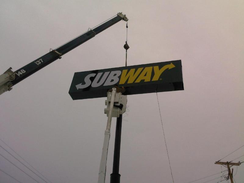

skyhigh
ok
HulkSmash
Did you use a measuring tape and 1 man for that?
Let me guess, you searched for the biggest sign you've done?
yep, one man lifted that sign. Nothing gets by you.
Nope not the biggest, although I don't have too many higher.....a few.
That was one of the first pictures I came across of a "larger" sign install.
