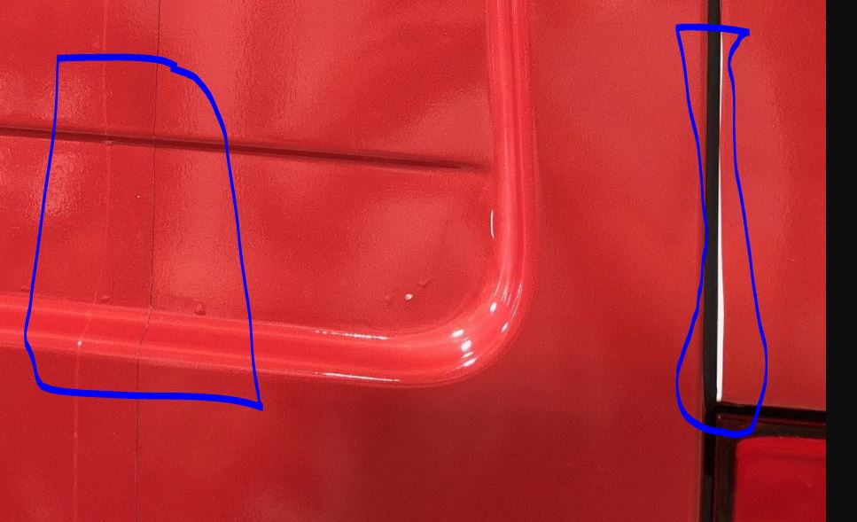

damn... this job IS NOT well done!!! those bubbles in red wont dissapear. They come from overheating the vinyl, but viny will pop-out in a few months anyway. bubles are the least they should worry about. and those small wrinkles also wont go away. it is a dammaged vinyl... Belive me, im talking from personal experience. We were all begginers. Only bubbles in letters will disapear, that is normal. And that panneling - unusuall location to seam vinyl...
Tell your customer to get writen guarrantie from shop, that this fails will go away in 6 months. Lets see what that shop will have to say about it.

mm in that seam photo, is the vinyl overstretched into the corner? Looks like it's fading a bit but I can't tell in the photo.
It's not a nice job. Bubbles are whatever, but the wrinkles are pretty bad. But as mentioned earlier, we're also careful not to crap on other local shops. It's one of those "mm, if you're uncomfortable with it, you should go talk to them..." situations

Just looked closer at these. So, this is a seam? yikes...that doesn't look too good and in a bad spot. The other circled part, is that a reflection or does the vinyl cut short? yikes, that doesn't look good either. When you blow the pic up you see more wrinkles.

The photos you posted are far from being the worst I've seen. No its not correct or perfect, it looks like an inexperienced installer and a job that was quoted too low where they didn't have enough profit in it to reprint the panels that needed to be, not saying its correct but it happens.
If this happened in my shop the client would get 2 options
1- I reprint and redo to sections with wrinkles, bubbles will be popped and will disappear.
2- I offer them a discount, some clients are perfectly happy with a few hundred bucks knocked off, they feel like they walked away the winner.
At the end of the day its a work truck, not a show car, if the wrap looks good from 8 feet away its mostly fine.
