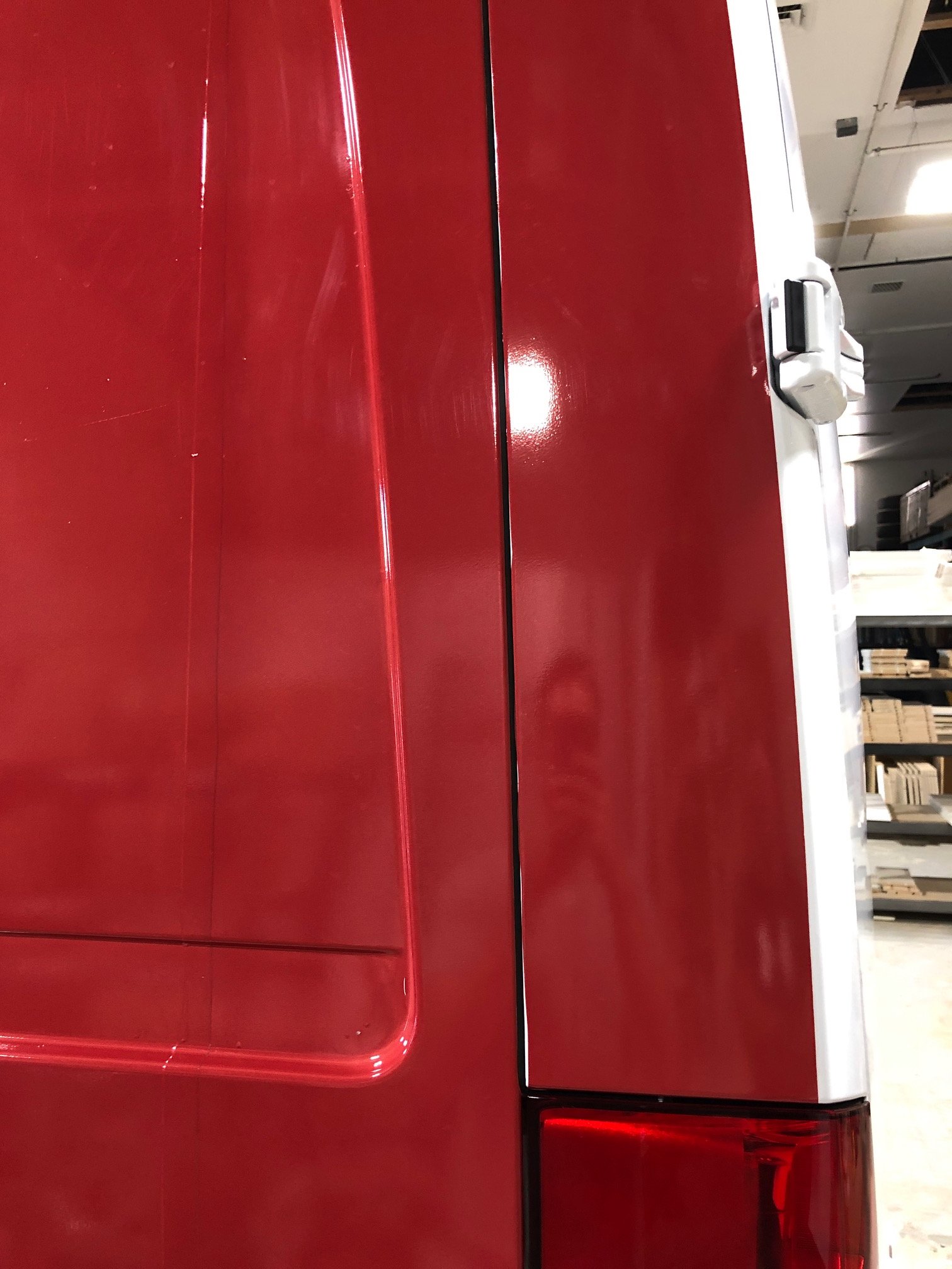

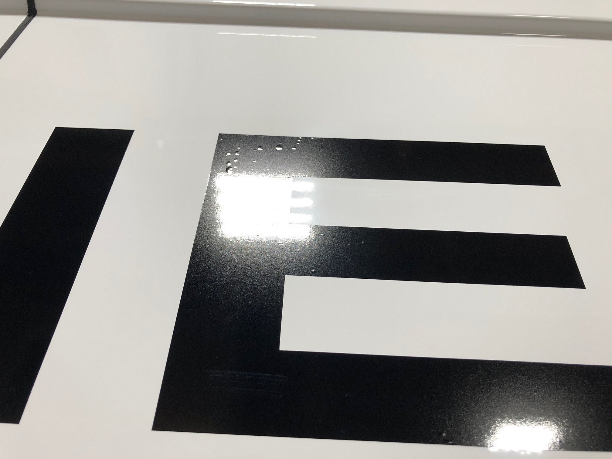

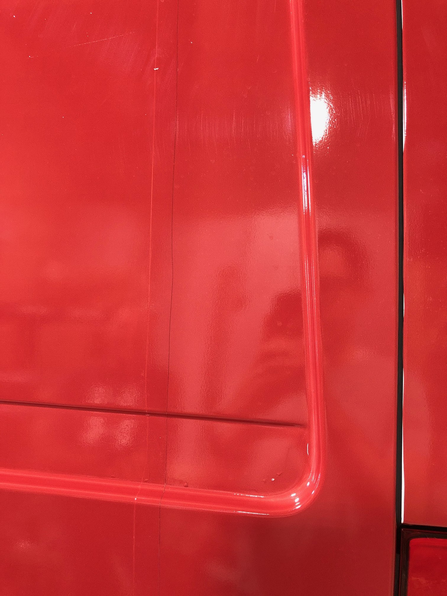

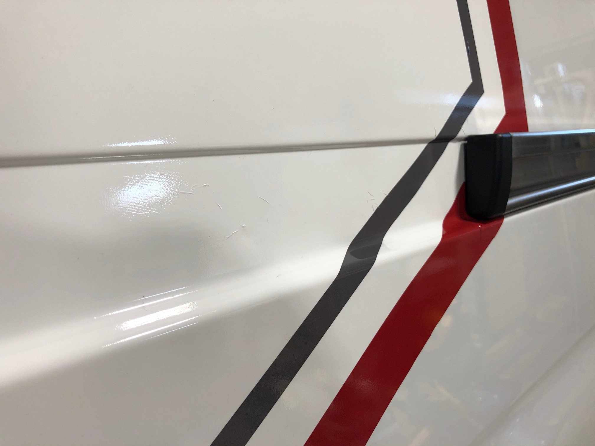

we recently had a client come in and ask us about a job he just had just got done from another shop. He was asking if he had a shotty wrap done or if this was the norm. He would have brought it to the attention of the shop but he didn't take a close up look at it after it was done and it was only when he got home did he take a full close up look. He said there were wrinkles, bubbles, and pieced together spots. he called the shop and they said that this is normal and everything will flatten out over time.
we told him a lot of the bubbles will dissipate and flatten out so that is normal(doesn't look good at the start but they will go away) and depending on the material the small wrinkles might do the same(cant guarantee since we did not know the material).
After seeing this wrap I am wondering what others will let go and what would be called for a reprint?
attached are photos for a reference.

The only thing I see is, perhaps better planning where the seem ends up, but not seeing the overall scheme of things, it's hard to tell. Ya never wanna be in the middle of a squabble like that. I'd just tell him, it looks fine and be done with it.

The seams are ok. The photo with the bubbles (image2)....those shouldn't be there if it's proper air release wrap vinyl. They should press out with a finger. The other wrinkles (image 3) is pretty bad to me, and indicates it might be 3m 180C, as I've had that issue with the stuff. They might flatten some later, but not much.
SightLine
The wrinkles are a bit of a problem. Easy to miss a bubble here and there when installing but we always make sure to move around a lot at the end to change the lighting angles to catch any. The wrinkles should not happen, that is an installer inexperience issue. Are they bad enough to warrant a re-print? That depends on where they are, how bad, how many and how the client was educated on having realistic expectations. Give a client no information and they will generally expect an award winning show car install if they do not know better and have never seen another typical wrap up close. Can we do a show car quality wrap, sure, but it will cost you a LOT more.

Have you guys ever had wrinkles like that go away? If you get a small wrinkle like that... heat usually will push it out and into shape (While leaving a mark). But those look like they were big wrinkles that have already been heated down... so I doubt they will go away at all. If they would... I'd expect the shop to have done it! They wont go away on their own without heat / pressure.
Is the black vinyl a print, or cut letters? It looks like cut letters to me... in which case there shouldnt be nearly as many bubbles...and I get a feeling they cheaped out on the vinyl for that... in which case I doubt it'll go away.
The joins on the back as well...such an odd place to put it...as well as the big white section between the doors, it looks more like the vinyl has already shrunk from over stretching in that area... which is weird!
all in all, I'd say it's not a good wrap job. It's something a "Sign shop" with a printer/laminator would spit out without proper knowledge of how to wrap a vehicle which happens all too often. That... or it was done by an installer in training, or someone having an off day.

I wouldn't say that was a good job. The seam isn't done well and is that white showing through on the panel behind it? And the wrinkles look like they were worse and that's as good as they will get. Whether it's an acceptable job is another question. Some clients prefer price over perfection and some trucks aren't worth being fussy about. But that should be settled up front.
Sorry....... I was just looking at these pictures on another computer. Now, I see the folds and wrinkles in the white. Yeah, that's not too plenty good.

Cant tell from the pictures what it actually is but it looks like some text and 2 stripes with a pinkish red back? If that's the case, why wrap the assumingly white van in white to get 2 stripes and black text?
