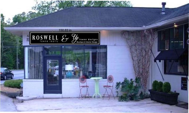

I have a customer that wants me to paint a very simple two color (black and white) sign one of her exterior walls. The wall is wood, almost looks like a tongue and groove style board. In between each panel is a 1/4" "V". The wall is painted white with an exterior grade semi-gloss latex. I plan on using some Oramask as well. Can I clean the area real well and mask off the areas that need to remain white (as the wall is already white) and use black latex, and be done? If not, I have been doing some searches on here and think I have an idea of the process but would love some feedback. I was thinking of masking the rectangle and then using a kilz product designed for outdoor and to stick to smooth surfaces to prime the area(should I prep sand the existing latex?). Then I was going to paint the area black (ronan or 1-shot?), and finally lay mask and stencil the white text and border. Does this sound right? Can I use all latex paints? What type of brushes/roller should I use? How long should I let the black dry before laying my mask? Any help is greatly appreciated.

Being a sign painter I hate to dissuade you from attempting to do this.
But if it were me I would just make her an Alumalite/vinyl sign.
It would be so much easier, less labor etc.
Those are awful thin letters to be painted on an irregular surface, and will probably ebnd up looking funny if you are not used to painting.
That surface (looks like T-111) sucks in paint like a sponge.
In my experience, working with a mask over latex is pretty much just asking to peel up the background paint, and you will never get a good crisp edge on that surface.
If you want to tuff it out and paint, you can either project the image and draw it out with charcoal, or make a pounce pattern (the graphite powder will make a hard to clean mess on that surface) and paint with Ronan and a fitch.
Like I said, Alumalite may cost you more in materials but you will be saving yourself hours of headache. Practice painting on your own garage wall, that type of thing, before you try doing it for a paying job.

buy a 5x8 sheet of black dibond. You will have one seam up the middle.
There is no way you will paint the small letters on that T-111.

I would do what Jill and sky high said.
Why did the client suggest paint? Is it because she has to have paint for code or she thinks it will be cheaper painting it on the building.
A side note, I would rather paint a old brick wall then texture 11.
JR :)
You have just about everything going against you if you paint these panels as is.
Your paint job will only be as good as the paint job which exists on that wall presently.
As the others have said.... an overlay of whatever material you choose will look better, last longer and cost less to do.

WOW, Thanks to everyone for the advice. The customer stated that code is a wood sign, so it was a choice between painting the wall directly or doing MDO. I was thinking it would be easier to paint the wall directly, I am seeing that is not the case. I am glad I asked the question. I just called my supplier and all I can get is 1/2" 4x8 MDO. I think I will try to get them to do the alumalite or dibond route. Thank you again.

In your picture it looks like you are running the edges of the sign right up to the edges of the area.
Leave yourself a little space, make the height of the sign 24" and get the whole thing from one 4 x 8. It will be more cost effective and it will look better.
That was the plan before the idea to paint came up.
