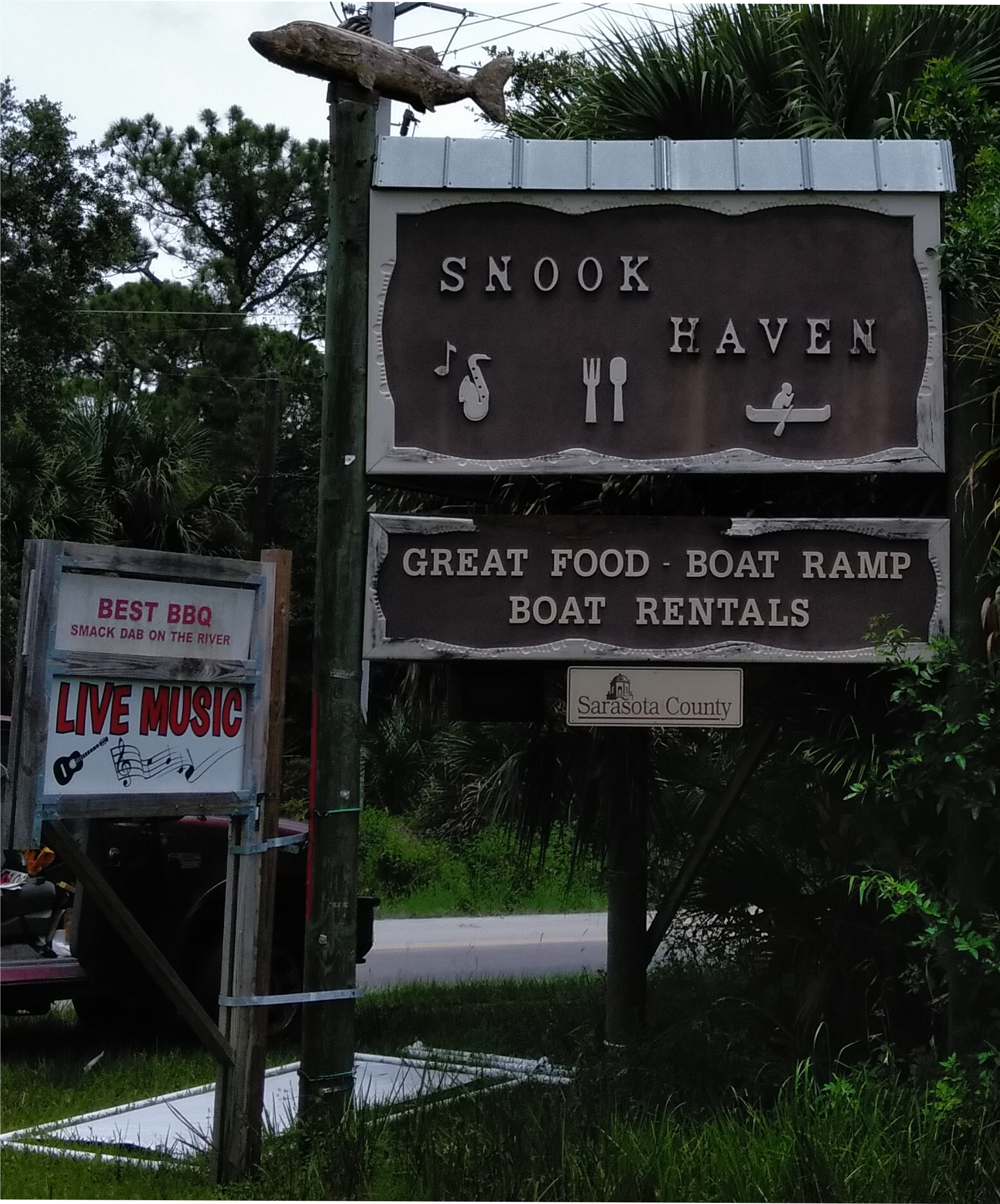

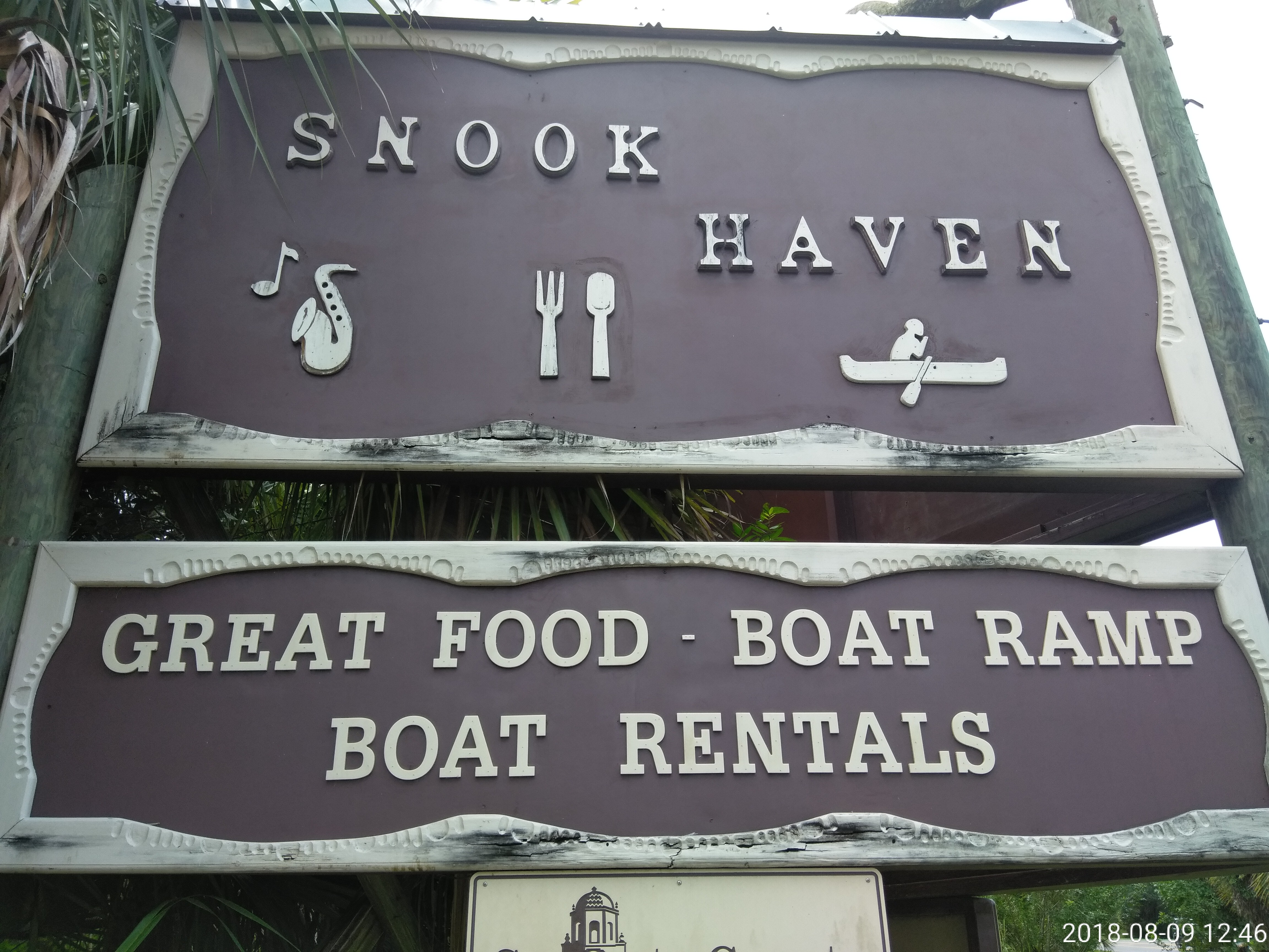

I am going to repaint several old signs and need some tips. I tried desperately to get them to buy a new sign, but they won't go for it. The old paint is oxidized and has some mold ( the wood has rot too) - the sign has raised wood letters on a plywood background. There's no hose or water access at the location, so I can't power wash it. My biggest question is WHAT TYPE OF PAINTS & PRIMER would be best? I'd like to stick with latex if possible. If it was just some lettering I'd get ONE SHOT, but the signs are 4x8's. I'd like to spray the the whole thing with a primer, then spray color on the wood letters and come back and paint the background with a small roller & brush. The colors - BRIGHT RED background, TAN & CREAM for the lettering. Please take a peek at the attachment and let me know what you think, thank you!

can you remove the sign and do it in shop? that might be the easiest

sand and prep just like regular house painting clean after with TSP rinse it off and let dry .Use a good primer sealer first then two coats of finish colors. you can use a small hudson sprayer for remote locations with no water . The better the prep the better the finish

IMO I wouldn't do the job. No telling how far the rot has gone into the sign or what other problems are lurking.
Another issue with those type of clients is once you touch it you own it. Meaning the least little thing goes wrong you won't hear the end of it.

I will forgo the bah blah blah about the quality of that sign and what should be done. Like Studio 440 said, treat it like any other outdoor wood repaint job. The garden sprayer is a good idea for washing and rinsing. I'd throw some wood restorer/hardener on the rotted spots. Finding a good red latex that will hold up is tough. I'd use an industrial enamel from a good commercial paint brand. Not sure if I'd do the background first, then the letters or the other way. The problem with adding the background after is getting a good even smooth coat, any thin spots will fade quickly. So I would spray the primer, then spray the red, and go in and finish the letters & border by hand, it's take two coats but should look good.

it's a county owned sign and I bid it appropriately to cover all the labor & materials. I can replace the border as needed (I think I'll just replace the whole border trim so it matches) the small 2x8 sign on the bottom has plastic letters that are in good shape. I'm going to mask those off and spray the primer & paint on that one, shouldn't be too hard. I like the idea of the industrial enamel, seems like it should hold up well to our weather. Thank you for all the tips and things to watch out for!

The amount of time it's going to take to repaint these signs will far outweigh the cost of replacing with new aluminum composite signs, depending of course on your labor rate. Like was mentioned before, there's no telling how bad that wood rot is until you start working on the signs. I suspect it may be more than it appears. If you do decide to repaint make sure all the oxidation is removed or the top paint won't stick. I would use a good quality acrylic latex house paint. I've had good luck with Sherwin Williams colors not fading, high quality line.

You cannot do this job properly and have it be done properly.
Day 1: Clean sign the best you can. Prime with latex primer. Go to lunch. Spray the entire sign with background color.
Day 2: Spray sign again with background color.
Day 3: With a roller/brush paint the raised sections.
That's 3 trips out for the sign.
As for brand of paint. Frankly, latex paints all perform pretty well as far as keeping their color. Even the cheap ones say they are good for 20+ years. I'd be more concerned with dry time than anything else. If you can use something like PPG Breakthrough paint, you could probably cut one trip out because it dries much faster than typical latex paints.

Just go to Home Depot and get the primer and paint latex combo of the color red you want. and a quart of beige in the same type of paint. Put the red on and then go and with a small nap roller and "tip" the raised copy. Don't make such a big deal out of a cheap sign with same kind of owners.
When in Home Depot buy a can of Off Deepwoods with deet so as not to get the blood sucked out of you by Noseeums when painting the sign.
Also, show, don't give it to them or email it, a new layout of what a new sign would look like.
BTW, Snook season in that area ends today, Aug. 31st.

That being said, if you really want the job, I see it's a 'V' shape sign, so everything is doubled from supplies, to time to moving ladders, tarps and whatnot. Hopefully, we're seeing the lousy side. The letters also look bad on the top sign, but not on the bottom. Perhaps, one is wood and one is plastic or something. It's not easy to see the condition of the edges of those letters, but Johnny Best has the best suggestion.
I'd hand wash the whole sign with soap and water, then spray it with clorox and rinse again a few times. Prime it, top coat once or twice and then the letters with a 3" roller.
