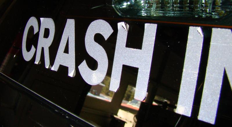

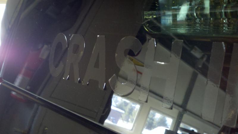

It is not chrome its Oracal 5600 Reflective.
Peeled the lettering off both windows and one side left almost all the glue and the other side most of the letters came off without leaving hardly any glue behind. Took both sides off the same way just pick at the edge and peel away.

Showing us a picture of glue residue is a mean trick.
You should be whipped and beaten until dead.... and then taken out and killed. :rolleyes:
cabo2010
None of the pictures were of just the film. Just the angle of the picture showing the edges lifted.
