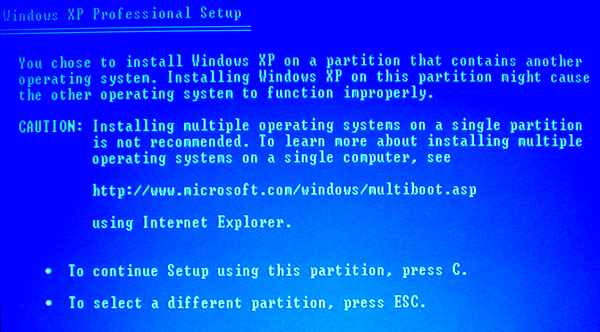

hmmm, I went ahead & selected the "fresh install" option, which brought me to the list of partitions as Michael said it would. The c drive was the only viable drive. There was a 8mb "unavailable partition" & then several "NO DRIVE" notifications... so I selected the C drive & got this message:

Michael, you don't see the attachment?
Well, it says something like;
"you are trying to install the operating system on a pasrtition that already has an OS on it.
If you continue, things may not work correctly,
if you wish to escape, you can choose another partition,
if you wish to install a second OS, consult microsoft/dualboot.com or somesuch addy.

ok... i just saw your latest, so I hit esc to go back, then hit "D" (as prompted on-screen for "delete")
..but it said, I can't delete that partition because some files exist on that partition that are required for set-up. hmmm... I wonder why that is, the disc is in the drive & it should be the only files needed ??

Michael Adams called last night & quickly realized that I had loaded the XP installation CD into the computer, but had not properly booted from the CD.
Once he walked me through that process, the "set-up" moved forward as it should have with the formatting followed by the fresh install.
