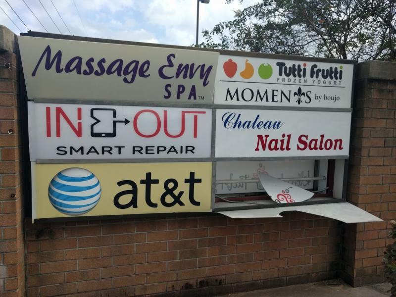

Hello.
Our customer wants us to "update" their monument sign.
15' x 8' x 2'
I am offering them a new sign cabinet. That is simple.
But what can we do about the bricks?
Get them pressure washed? Or painted?
Thank you!

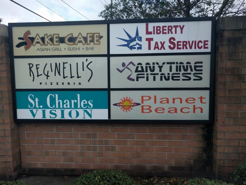

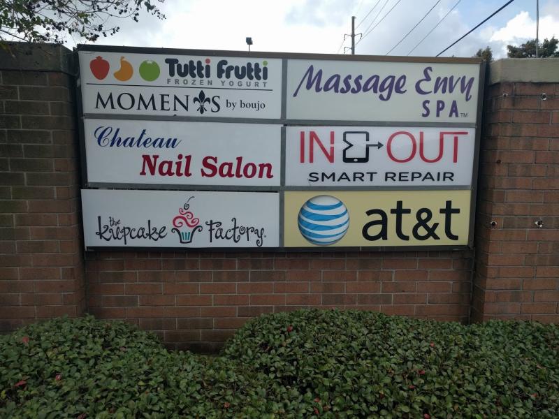

can you give us a picture standing back further? The way the sign is crammed into that base is somewhat atrocious, I'd find a way to utilize the base more than it is currently being used, maybe expand to the top of the structure. tough to come up with more without seeing a better perspective of the entire area you working with.

There are two monument signs, that's why the cabinets have different business names on them.
