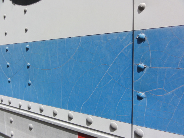

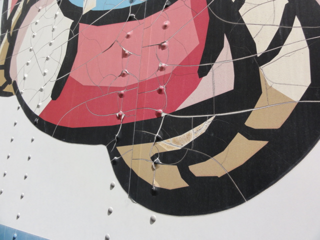

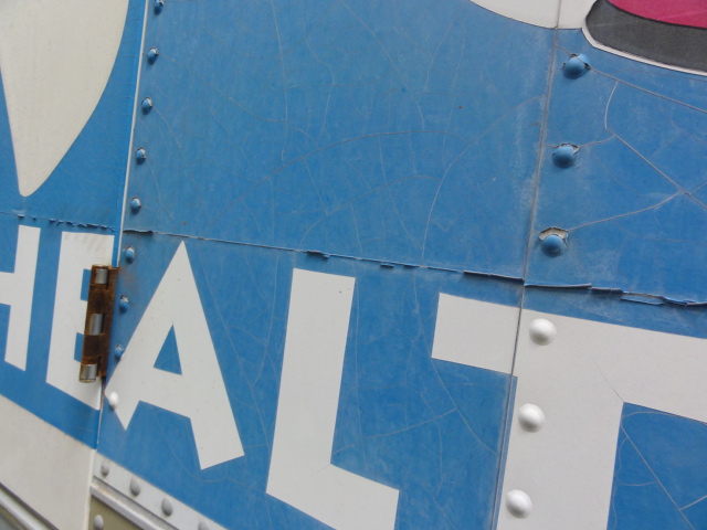

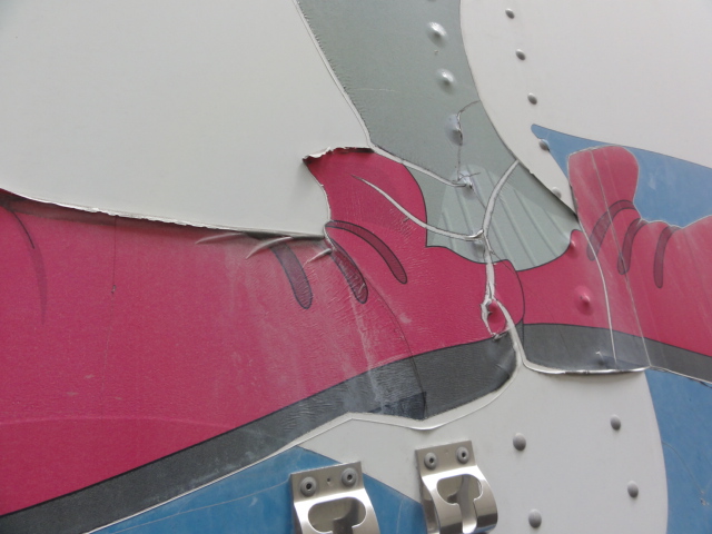

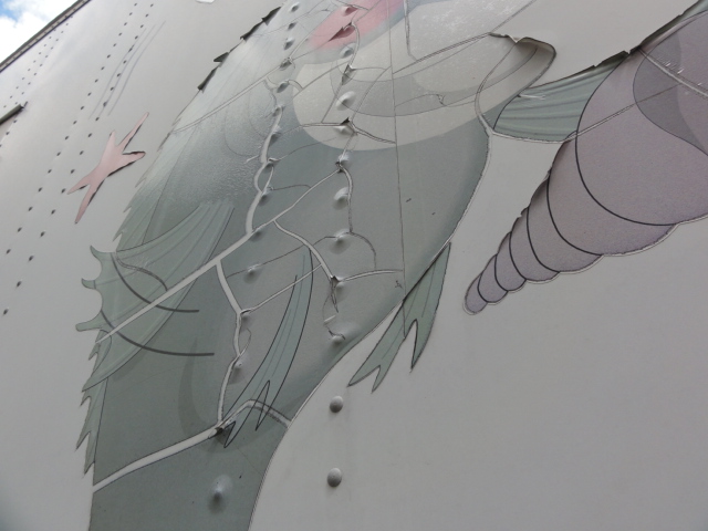

So we have a 53' trailer with old, old, very old graphics on it. I have no idea who did them originally and it looks like a complete scramble of films and sizes were used. As far as I can determine we have 3M 180c with what looks like 15" Avery A9 & possibly 3M 7125 sections. The .040 aluminum skin is heavily oxidized and the graphics have deteriorated badly. In short, this is a removal nightmare. We need to get all of this old stuff off, clean the entire skin and do a full wrap on all four sides. Does anyone have a tried-and-true method for a removal like this?
