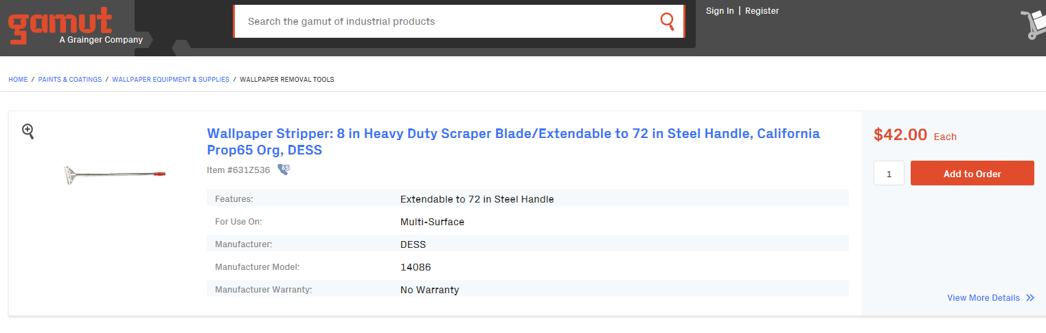

this looks like an 8" version of the standard 4" scraper most use. It also have a handle that lets you reach farther. The wider blade might help speed it up some.
I got one of those last year and used it to remove vinyl floors, thanks for reminding me about it!

I agree with BillC2 (use razor scrapers) Not the large one because they are very difficult to lay flat on glass. You need to use the regular 3" blades (purchase at Home Depot along with several 100 pk blades)...yes, it takes time, but it is the quickest, non staining, least messy approach. I have extensive experience with window paintings application and removal. You have to charge them according for the labor. One window you can go through 7-8 blades...the paint is very easy to remove with sharp blades.
