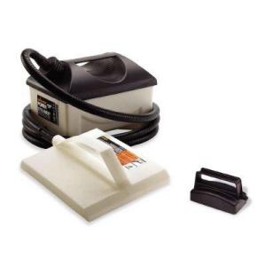

I own the drill eraser too...and works really well...but after reading the posts..will not work on alluminum...leaves a haze...the drill attachment only cost $14. Fred...how does the steam penetrate the vinyl? Do you use the unit just like you would on wallpaper???
Yes, that is the unit I use. It works very well on sheet stock and okay on cut letters. What works so well is the wider, more even and just right application of heat. It softens the vinyl and adhesive just enough to make it peel off nicely and with little to no adhesive remaining on the substrate.
do you have to use a pounce tool to make little holes so the steam get in there under the vinyl?
