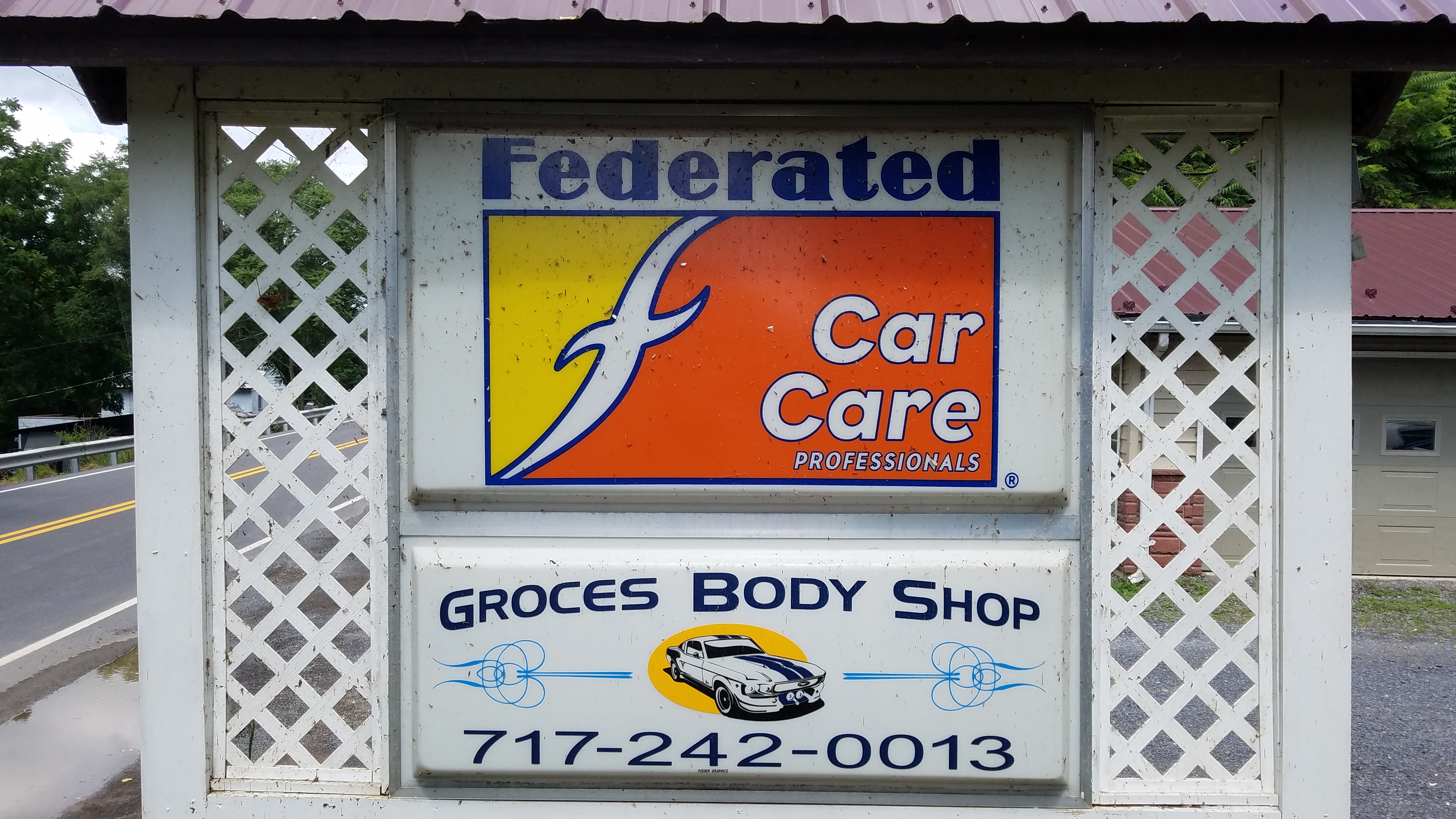

I got a call today from a customer who wants to re-face an existing backlit sign face with a new decal. His idea was to just cover the old one with a new one but since it's backlit we all know how that would turn out.
The first thing I thought of was to remove the image from the sign face (extruded plastic) but it looks like it was screen printed on. If you look closely at where the orange meets the blue you can see that the blue overlaps the orange. That's what makes me think that it was screen printed.
The customer (body shop owner) told me that he's tried to sand these things in the past (which I know isn't a good idea anyway) and had no luck. He said it's almost like the image is "on the inside".
So my question is, does anyone have experience with removing "screen printed" images from lexan / polycarbonate / plastic sign faces and / or what is my best option?

We used to strip faces like that a long, long time ago. Laquer thinner and sawdust is what we used if I remember correctly. The sign isn't screen printed, it is painted. There are most likely a lot of cuts into the back of the face from the masking process, you will never get all of the paint out of those cuts.
You'd be a lot better off replacing the faces if you can.
If you've never done this before, you will cook the face, taking the old paint off and ruin it. Go to the customer and tell them from a professional standpoint, it is better to just replace the faces. Otherwise, he should look for another sucker to do it the wrong way.
Stripping those things was usually the job of the shop boy (person). It was smelly, horrible and hard on your fingers. So, while it can be done, you hafta be good at doing it or else.......................

Sprayed not printed, what everyone else says...new faces. I've used grip flex in the past to remove but only did it once. The time it takes to do it right and then still end up with very stressed face from all the chemical and elbow grease makes new faces cheap.
unclebun
We used to use denatured alcohol to strip the paint off those (it is on the inside). Fill the pan with a double layer of paper towels, like you're making lasagna. Soak with the denatured alcohol and keep it wet. It takes a long time to soften the paint. When the paint softens, use a putty knife to scrape it up. It's about like removing a heavy coat of adhesive, but worse. Keep using lots of the alcohol to successively dilute until there's no paint left. Then you have to respray it white with the right kind of translucent paint, if you're going to put vinyl on the outside. Or you can paint it.

Nasty job removing paint from Backlit faces. Done alot of them in the past and it isn't cheap. Quote New Faces

Most likely spray painted on the backside, then covered with white lacryl or gripflex, if it's a polycarbonate face try alcohol [in a small safe area] if it's acrylic you can probably use laquer thinner [test first] your testing to make sure you arn't melting the face, just breaking down the paint and wiping off, do not let either liquid sit on the face for any length of time. Test in an area the retainer will hide.
