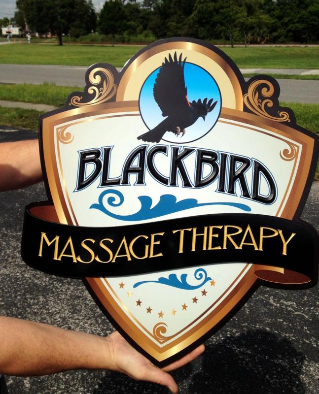

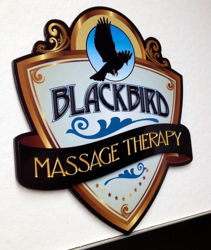

Keith an employee of mine, was asked by his niece to make a sign for her to be displayed at an upcoming renaissance festival, and he asked me for some help with it. I designed it and he did most of the work putting it together. A mixed media piece. Digital print on 1/2" PVC, profile cut and edges painted black. Applique prismatic letters on the print along with a v-carved raised ribbon panel. Sign is about 2' x 2' in size. I'm tempted to make a second one for my showroom wall. I like the way it turned out and it was an easy sign to make.

Thank you all. I have done quite a few signs in a similar fashion as this and the combination of effects and mediums make these really stand out nicely. Gotta keep pushing the limits!
