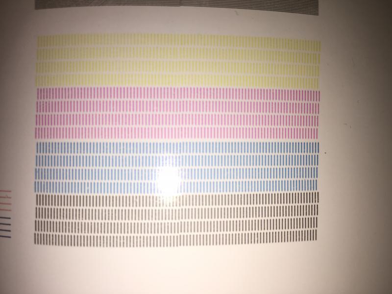

Roland SP-300V not printing??
CrAkD
Trust me and buy new captops from Roland, not knock offs, Roland caps. Your black is drying, and the pump is not cleaning the head.
The rubber captops seal the heads and keep them from drying out. They go into the pump. If the caps are older or not sealing (or the foam inside them has swollen) the pump cannot pull ink through the head to clean and clear the heads.
The wipers are also an important part of keeping the heads good. Replace them as well.
Do you know how to do a manual cleaning? I do one every week and after every print job.

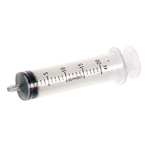

You will need to pick up one of these also. Got mine from a local feed store.

Yes do the carriage maintenance thing. You turn the front power button off. Then hold the cleaning button down, and turn the power back on. This puts it in the manual cleaning mode.
When you clean the head, you wipe all 4 SIDES to remove the ink from the sides. Just don't wipe the bottom of the head. I soak a swab, wipe the sides, using a Bounty paper towel I squeeze all the cleaner and ink out of the swab, re-soak the swab, and continue to wipe. I will use 1 to 3 swabs to clean the heads. I have a small bottle that has a little squirt top so I can put a few drops on the swab easily.
There is a trick when the head is not coming clean that you soak a swab with cleaner and bring it up to the bottom of the head and just barely touch the head so the cleaner can be pulled up out of the swab and into the nozzles. Hold the swab there for a minute or two, but do not move at all, and apply ZERO pressure.But I would not try this until you have replaced the caps and wiper, done the basic manual cleaning, and then let it sit for a day or two.
I find pressing the cleaning button daily on the front panel does more for removing deflections and keeping the head clear than anything. Plus the weekly manual cleaning.
And good caps and wipers...

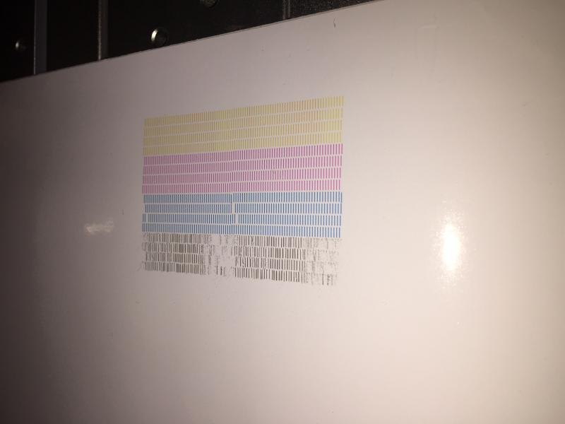

just wanted to update everybody. I had a tech i met from here come over and give me a hand with this machine since the shop i bought it from wouldn't help me. He replaced a damper. cap tops and wipers are new. soaked heads 24 hours. black is still a mess looking like the black/cyan head needs to be replaced which is odd because the cyan looks ok but black looks awful.
splizaat
Our SP300V black/cyan head is similar. Cyan nozzles are PERFECT. Black head has about six small deflections....It happens.
Glad you got it sorted out. Even though the nozzle test is showing funky, have you tried printing anything? How do the actual prints look? Our black head has those deflections but no customer has ever mentioned it.
CrAkD
i do a lot of black on white stickers....we tried to do some tricks to try to hide the black defects but you could still see the banding if I can't get the shop to replace that print head I may try to sell some full color jobs to try and fund the replacement head.

Hey, did you check if you have a cracked manifold?
One of my DX4 printheds was drying out over night and the reason was
a broken tip out of the two tips on the manifold. That makes air leak in and makes printhead
looks clogged but it's only because it can't hold any ink in it.
Get damper off and try very-very gently with your finger tip to "feel" if the tip of the manifold it's broken.
Even the slightest crack can cause a problem like what seems on your jpgs. The manifolds are cheap to replace
but you have to take the printhead out, replace and then put it back on.
The real trouble is to re-calibrate the heads though...
phototec
I didn't use my printer for two weeks and had a similar test print like yours, I did a couple of print head soakings (over night) and also the trick using a swab soaked with cleaning solution and VERY VERY LIGHTLY let it touch the surface of the black print head to dissolve the dried ink on the head (DO NOT RUB or DRAG on the head, just light pressure.
My black test print looked worse than yours at first, then after doing as noted above, I have almost a perfect test print now. So both the head soaking and the swab trick worked for me.
