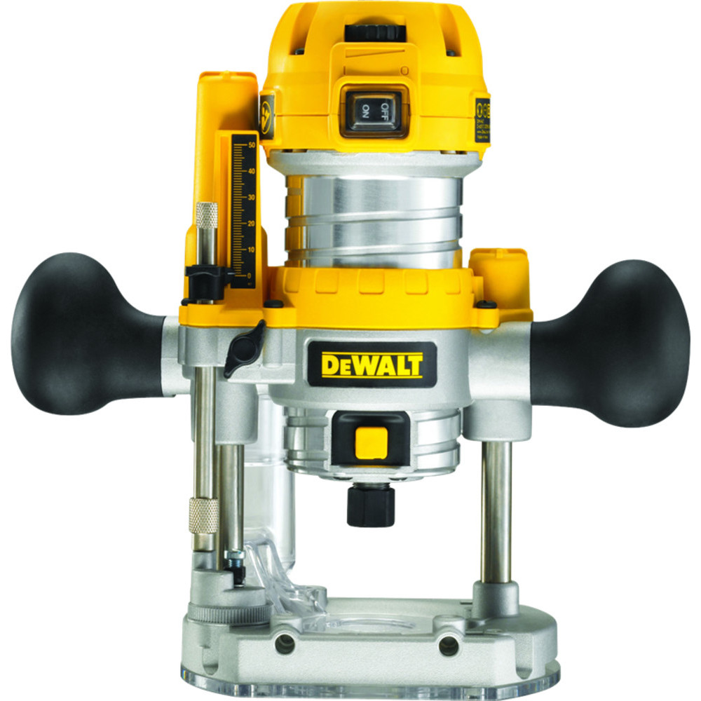

ok thanks. a router is what I thought I needed. I figured the cost of the tool when bidding this job... adding to my dewalt collection

I appreciate all the advise here. Normally I wouldn't venture into this kind of job because I'd rather just stick to what I know... but it's for a local sign company that uses me a lot so I thought twice about turning it down. I got the router, straight bit and a guide for a hair under $200. I figured in the bid $300 for the tool and bit so it's enough to cover. The router was on sale on Amazon. I'd like to expand my wood working skill so this project will be fine. They want 1/2" MDO sign in those 4x4 posts, and the top two corners of the sign are rounded, so I can use the jig saw for that part....

Is it a plunge router, so you can set your depth and lock it in ??
Just be careful and practice on an old scab piece first. Your main concern will be to keep the fence/guide right up against the outside of the post. If that varies, you'll have a crooked rout. Once the rout takes shape, it's not easy to get a new groove going..................

I don't know about plunge, but the depth is fixed and I can adjust it by turning the dial or collar.
Moze
Yours will be fine. A fixed base is a bit easier to operate than a plunge.
