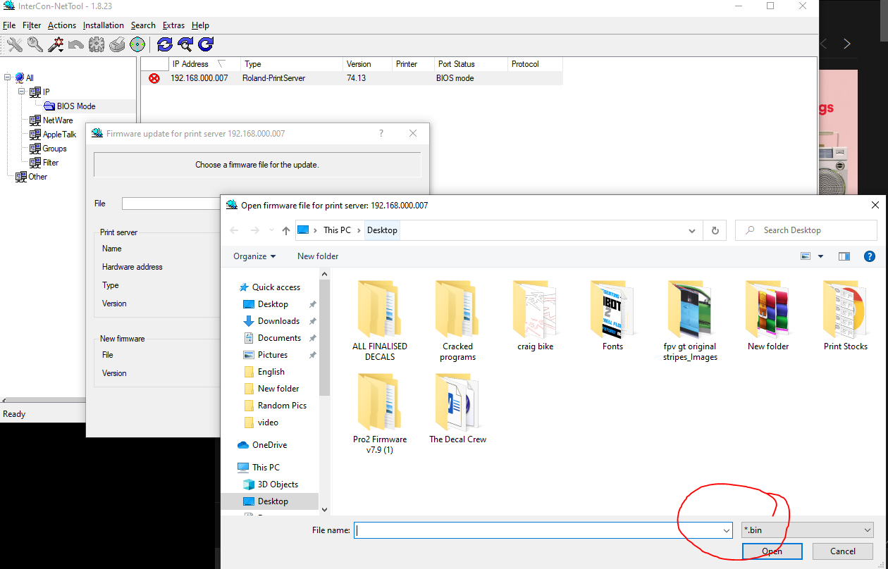

Now, when I search for the machine on the roland print server program, the machine does show up! BUT, under port, it states 'BIOS mode'. When I update the iP adress and refresh, the red cross on the left stays the same and the BIOS mode is still up!

Appreciate the reply! and yes i have tried that! But the firmware update only has provisions for Win XP or NT :(. The firmware update is requesting a *.bin file?

Yeah I don't think you are supposed to use that for the printer firmware update.
You probably need Peck tool and the FW file for that.
...Or that updater that netsol linked...

Not finding much. I would suggest resetting the network card on the printer, connecting the computer directly to the printer for this step and try assigning the IP address through the Intercon tool. Provided that works, then hook it up through your switch. Please update...

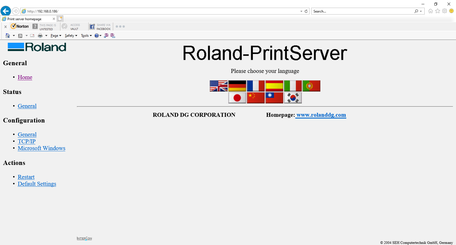

you said the printer returns a ping, so you know the ip?
mine is 192.168.0.186
http://<your ip address> should display something like:
netsol
give it a try and see what it displays,
Jim, is there something that stops the "server service"?
i have never seen bios mode, it kind of sounds like a failed firmware update perhaps?
Jim Hancock
Old School Technician
Don't know about stopping the "server service" other then opening task manager and looking for it there. Perhaps accessing the print server as shown above and either restarting or selecting default settings to see what it does.
