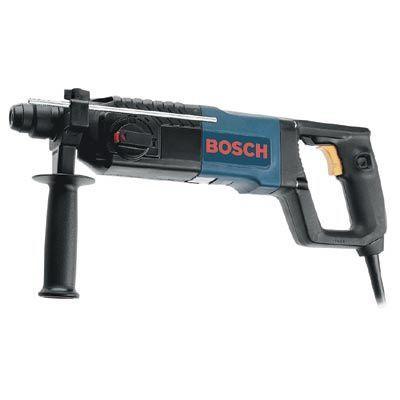

I've been running the Bosch Bulldog for 14 years and it still works great. Fantastic tool for the money.

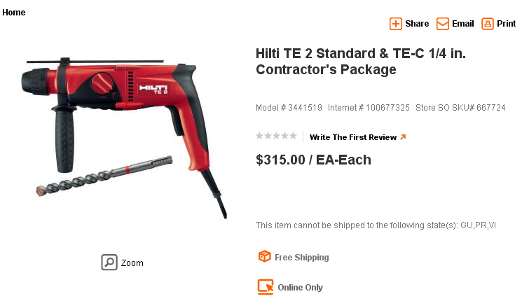

HILTI HILTI HILTI all the way nothing else comes close
Bosch is chinese junk. Once you use Hilti nothing else compares
Try stepping it up to this model if you can spare the extra bucks.Long run you will appreciate the extra power TE 7 + DRS Rotary Hammer Drill.
Also your price looks higher than the list on the Hilti website.
signage
If my memory is correct that drill has a maximum recomended hole size of 1/2". I would recommend a TE-7.
