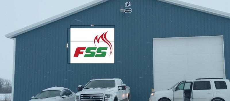

I have attached multiple pieces of dibond to the surface of corrugated buildings before, but I am never pleased with how the seams appear. Even if they are lined up perfect, they are quite visible and distracting. Any advice on this/similar experiences? Below is the mock up, I'll be using two 60"x120" pieces, so one horizontal seam. Thank You.

I would go with vertical seams as the building has vertical lines in the siding and it will help blend it in as you won't see lines going both ways. on thicker material you can lap joint the panels but not too sure you could cut that on 3mm

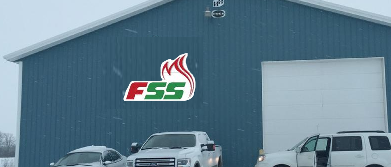

If you did something like this it would get rid of the more noticeable long seam and the flames would break up the seam there.

@ Thinksigns, very good idea and those are easy cuts so no need for a router plus is adds an improved view/layout to the sign

My two cents: Use a vertical seam rather than horizontal. Place the vertical seam on one of the raised ribs. A piece of VHB tape the length of the panels will keep the seam even. Use THESE the length of the seam (and elsewhere on the panels), paint-to-match the faces ahead of time.
