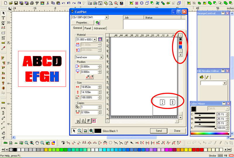

Can Corel X3 seperate colors for plotting out vinyl plots? If yes, how? If no, is there a program that can do this?
I don't know about X3, but Flexi automatically sorts everything by color in the Cut/Plot dialog.
