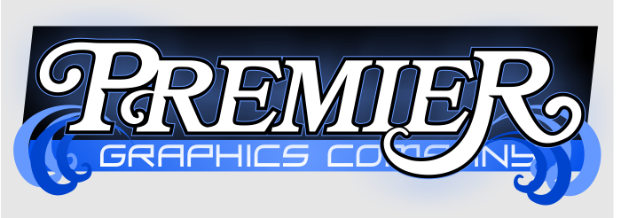

Here's the Bookman Swash I suggested initially. My R looks too big, in retrospect.
Lately my suggestions seem to go over like the proverbial turd in the punchbowl, tho.

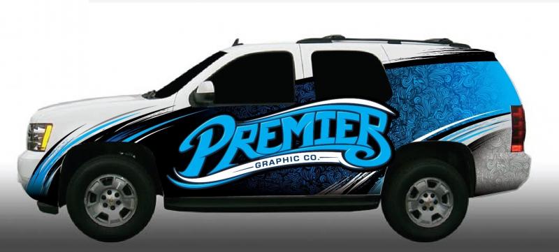

Ok, how about something like this? (Yes I need to add the phone # and website but I'm just working on the base design right now)

your swooshy things are going up at one angle and you name at another so it looks like your name is sliding down. what's with all the foo foo print in the swooshy things? you could have just a color or a fade, you really don't need to have grandma's wallpaper pattern or anything else going on. I know the "font" was done by hand but are you really loving it? it looks off and needs a ton of work to make it look good. if you insist on using it, making the background clean and simple might help
Joe Diaz
I kind of like it too Pat. I think the lettering for the logo needs a little help, but the overall layout is good. It's interesting enough without being overly cluttered, you can read it and it's to the point.

I have a busy meaningless wrap that catches peoples eye to the point I get flagged down a few times a week. Sometimes things don't have to read great or follow every design rule in the book in order to be effective....
Sometimes they just need to look cool!
That being said, I like both designs.... The new one does read easier though...
Joe Diaz
Why not look cool and be easy to read? You don't have to just choose one you know? In my opinion the excuse that it's okay if you can't read it as long as it looks "cool" is just that... an excuse. People don't need to flag us down, they see our name (clearly and easily) and give us a call or stop in. :thumb:

I also like it, the blue with the design is very nice. Marlene is in a winter funk right now and she will change her mind when spring rolls around and I always felt safe sitting near my Grandmother's wallpaper.

The hardest problem for me is trying to figure out where to put the secondary copy..like phone #, website, etc..any suggestions?
fmg
Nice looking design however not keen on the paisley blue swirl wall paper pattern in the blue.I can see more of a solid color there with the contact details added into that space.
Jillbeans
The wallpaper doesn't bug me, it reminds me of the "lace" effect used a lot (with paint) in Kustom Kulture.
I still reallllllly dislike the "hand done" lettering in the logo, it's got so many issues, which someone who really does hand letter would not do.
Secondary copy would go up in the bare spot to the right of the name.
Preferred the name in white with the ribbon thing in blue.
